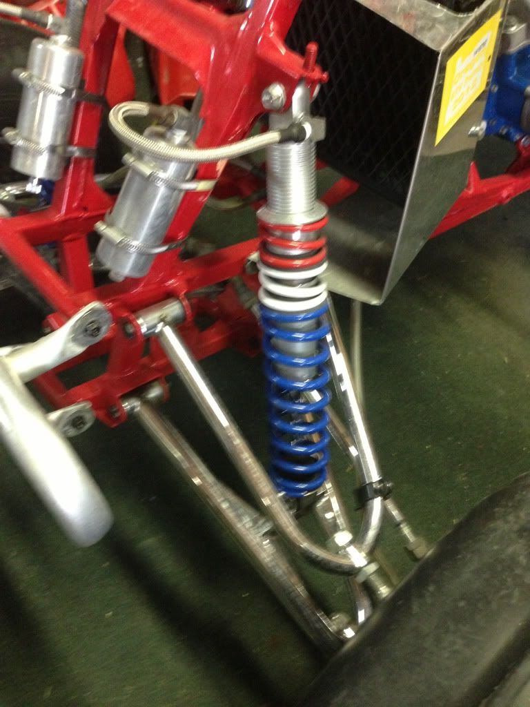

I need these shocks rebuilt.
I dont want to pay 450 dollars either.
I know they are works, but can anyone tell me any more about these? How do these shocks compare to oem 450r shocks?
How much would it cost to send them back to works and have them worked?
Thanks for any info!
:gorilla:

Just bought some chrome a arms from derby they are oem size and travel lsr
i have too tech rear shock on a cr500 and i really really like it.. but maybe im just not used to an actual functioning shock hahahaha

« Reply #5 on: September 09, 2013, 11:21:32 AM »
[ATTACH=CONFIG]1804[/ATTACH]
