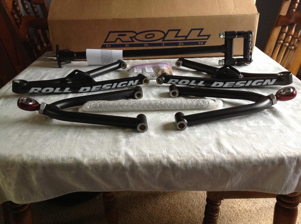

Anyone happen to know the shock length for Roll XC's?  The sub zero weather is keeping me from getting my front end put together and this is driving me crazy.  I would run 21" fronts and 20" rears on a OEM spec frame (Arens Bros).  Just curious if anyone did the 12" extended and 1.5" compressed measurement running Roll XC's and 21/20 tires.  I know there are other measurements to worry about but I'm mostly curious about the length right now.

Fresh off the press....2013.  It will be a while before I get a chance to get measurements.
I have Roll +3's and can tell these are defindently closer to standard length.

I think my lobo uses 17".  I'll check later tonight when I get home for sure.

Killer - does 16 3/4 sound right?  Paige gave me that number for Elka's.  Assuming it would be the same regardless of brand.

Yup that's the length on my axis too.

My Roll arms w/ my Laeger frame use 18.75 inch shocks. So i'd measure them to be absolutely sure. That's with 21" tires as well

I measured my lobo a few min ago. 16 3/4" and I also run 21" tires. I know roll mx arms use longer shocks like tbone has.
