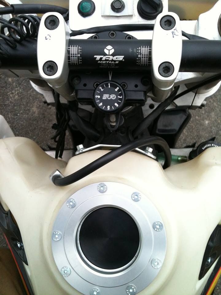

I just got done adding this to my 85 R, it should help keep the front end stable pounding through the rocks while racing! I made the tabs out of steel and tapped the bosses on the lower triple clamp. The mount on the frame has been modified from the steering stem clamp.
