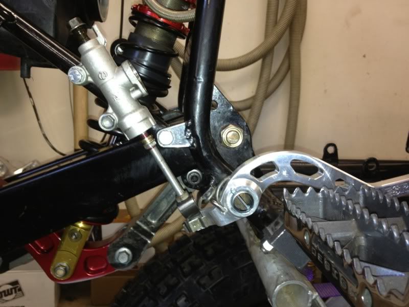

I have a 450 rear mc. All the 250 lines and reservoir hook up. I used a metric rod couple and a metric ending stud to extend mine. Worked fine.

I used a 450R m/c on my 88 trail bike. I just attached the 250R lines, and reused the pushrod from the 250R unit. No big deal, just remove the snap ring and swap parts.
