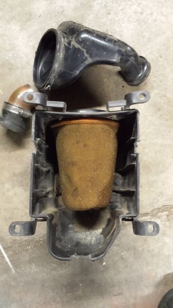

Here's a pic of a o5 trx450r airbox. I would probly say no go

Nice pic sam, it shows how the boot is straight out and doesn't go around the shock, and I am gonna get me a yfz boot for the walsh. Because the oem trx 250 boot has just a little disconfiguration to it.

That is the setup that was on my hybrid, it is also for sale..lol

I would make you a good deal on the setup in the pic

Correct, the box I reverse engineered for Jerry was originally drawn up by Mike (honda265r??)  anyway....  the yfz boot works with this box and has more room.  The 450r box will not work, I have both airboxes at my disposal and the 450r will not fit.  Note, before anyone tries to get a yfz boot on a stock 250r box, don't the yfz boot has a much larger opening where it connects to the box, you'll need a custom box which is what I modified on the original designed box from Mike.  So I can run YFZ boots, with 250r Uni filters and not have to pay 100 bucks more for the Pro Design billet ring and filters...  hope that makes sense.  I can make more of them.
