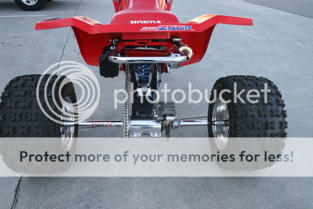

I never used the 250r carrier I always used the 450r carrier and axle. I used the GT Thunder link setup that Jason Hall recommends  on the standard 06 length swing arm and the +4. Biggest  issue I have always had is getting the right shock combination.
