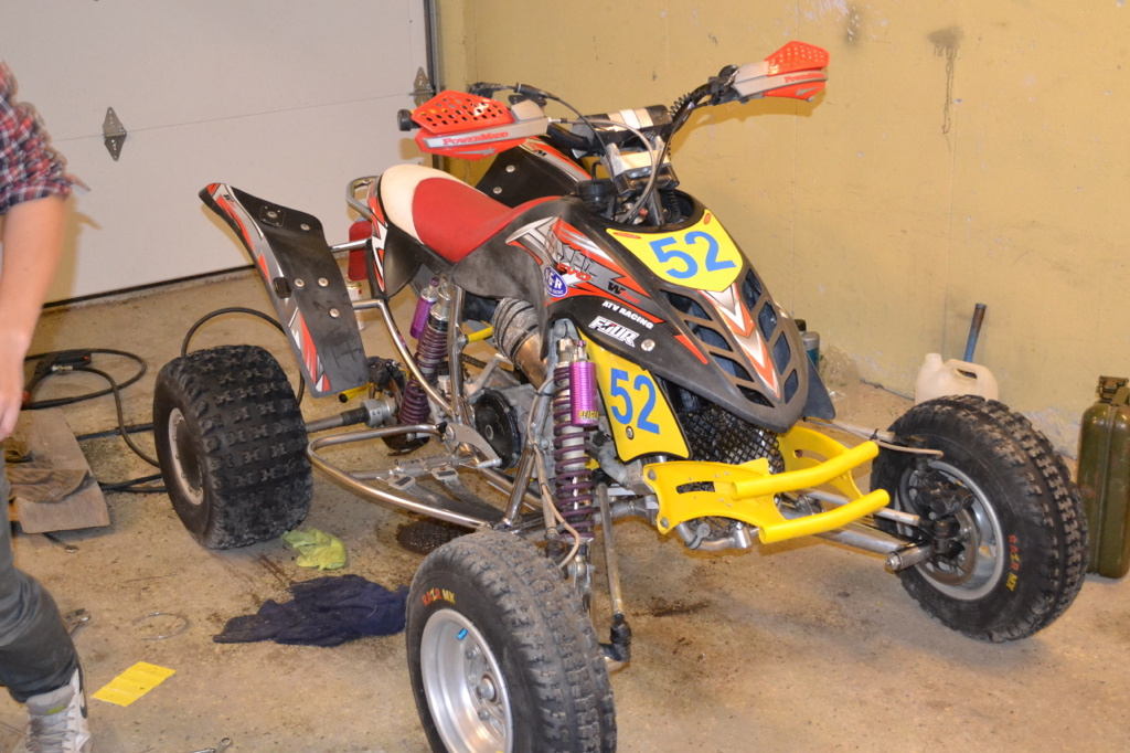

Hello, does anyone have any info into building your own chassis? Been looking into building a replica of a Laeger narrow frame with a no-link setup. But the problem is that i can't find any measurements or drawings of the frame.
I have all the info I need to machine my own protrax spindles.
The main reason for the project is that I have a gasgas ec300 engine that is standing on the shelf after switching engine in my last build.
I'm from Sweden by the way.

We all would be interested in pro trax spindles if you could make them. The specs are here in this site. I'm sure a few select members have the specs of a narrow frame. Hold on they will chime in...

What all do you need for measurements? I have a Laeger narrow no link.

I knew I should have done a drawing of it when I got it!!!

I would be glad if someone could help me get as many measurements as possible. Haven't had a "normal" geometry quad in the garage since 2012.
I would highly appreciate if someone could get me measurements of the a-arm mountings, shock mounts front and rear, swingarm mounts, suspension rake in the front and measurements for the steering stem. And if it's possible some measurements of a set of +4+1 a-arms and a no-link swingarm.
I would be very happy if someone took the time to do that for me. It would be a very kind thing to do. And I would without hesitation help you guys with anything you need. Like if I could get a line of protrax spindles fabricated.
