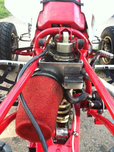

« Reply #62 on: August 01, 2013, 03:12:15 PM »
Intake bracket looks good lol.  Did you make sure to oil that filter?  Looks dry unless the oil has the red dye.

« Reply #63 on: August 01, 2013, 04:24:49 PM »
Thanks Tbone! Lol,I love that bracket Deuce,and I use No-Toil air filter,it comes out clear. Best stuff IMO. I will have better/more pics tonite when the sun goes down a little,too bright for good pics right now,but its sitting on the ground now!!

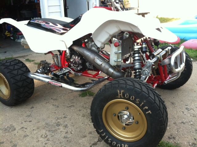

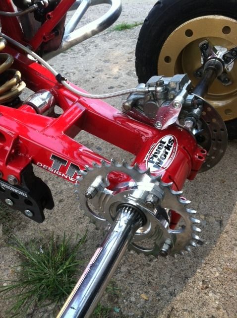

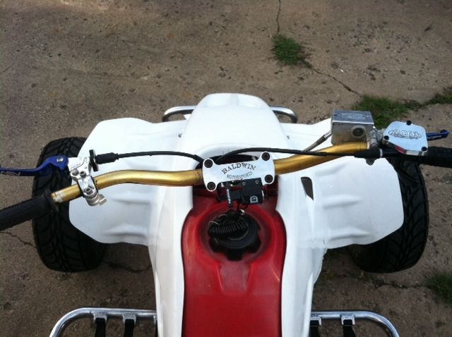

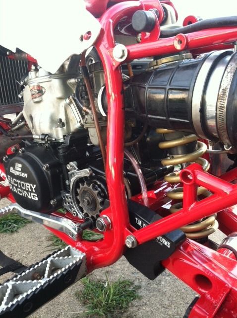

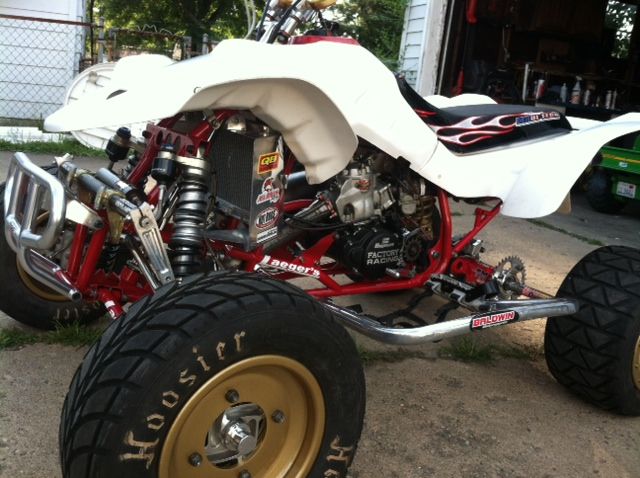

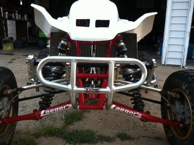

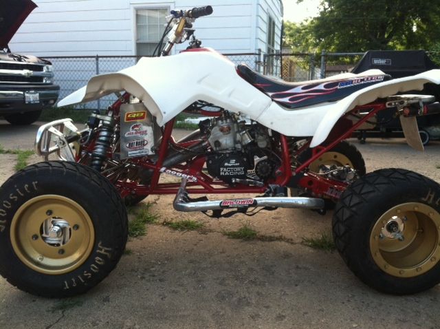

Not done,but close. Waiting on a few parts and need to make ANOTHER trip to Ace for sway bar bolts. Also an alignment and a few other little things,but it runs!!!

Offline 2strokesforever
Project Trailer Trash 02 Laeger wide
« Reply #67 on: August 01, 2013, 08:11:38 PM »
Very sweet lookin R.. I originally bought my R out of  Bargin Mart newspaper from a dude in a trailer park also
« Reply #68 on: August 01, 2013, 08:12:42 PM »
BTW what is the little tank mounted on the right side radiator shroud?

Offline 05450r
« Reply #69 on: August 01, 2013, 08:28:20 PM »
Thank you! That is the coolant rezzy,its from a Polaris Predator,Walsh sells them also.

Frame: 02' Laeger wide mx pro-peg
A Arms: Laeger Pro-Trax
Swingarm: Laeger CR500 shortened 2 1/8"
Steering Stem: Laeger
Axle: Durablue
Carrier: Baldwin
Locknut: Durablue anti-fade
Hubs F|R: Front Baldwin rear Durablue
Bars: Tag 1 1/8"
Brake/Clutch Lever: Asv brake and clutch lever,RIS rear brake pedal,yfz450 front master cyl,Zeta 400ex clevis
Grips: Scott
Foot Pegs: AC pro-peg nerfs with kick up extenders
Bumper: Tag LTR450 made to fit
Grab Bar: AC
Front Shocks: Axis hi/lo speed,comp and rebound adjust,X-link with PRS
Rear Shock: Axis cr500 comp and rebound with PRS
Brake Lines: Gafler
Rotors F|R: Braking front and rear,billet rear brake stay
Rims F|R: Dwt
Tires F|R:Hoosier
Janssen Outlaw 2 adjustable sway bar
Billetanium stick steering damper
Body:
Plastic: Fullbore
Graphics|Seat Cover:None yet,Maul Tech Atv seat cover
Fuel Tank: oem 86'
Engine|Drive System:
Cylinder|Head: Pro-X PV ported by Baldwin for Tim Farr
Bore & Stroke: 68x72
Displacement: 261cc
Crank: Hot Rod long rod
Carburetor: 38pwk as
Reeds:Cr250 with spacer
Air Filter|Box: JL eliminator Uni filter,86 boot
Pipe|Silencer: Sparks TT with DG silencer for Tim Farr
Clutch|Plates: Complete Hinson 8 plate setup
Gearing F|R: 12/36
CDI|Killswitch: 01' Cr250 with Pro Armor kill switch
Cooling: Ebay radiator,Gpi hoses,Ct shrouds,Polaris Predator rezzy.
Other: Rath rear master gaurd and throttle cover. Baldwin chain gaurd,stem to frame clamp,bar clamp and e-brake block off. Nacs front master cover. Hinson quick change cover with Merrill water pump cover. Boyesen stato cover, Complete TM design's chain guide kit.

That thing is looking great. Don't scratch your new powder when you rotate that right front.
Offline 05450r
« Reply #74 on: August 02, 2013, 02:34:06 PM »
Lol,I was wondering if anyone would catch that!!.. My coater has a tire machine,he installed it backwards,if he scratches it he can recoat it for no charge...LOL For some reason the wheels look darker than what they are,in the sun you can see more of the metallic in them. The color looked alot different under flourecent lighting,but Im still happy!
