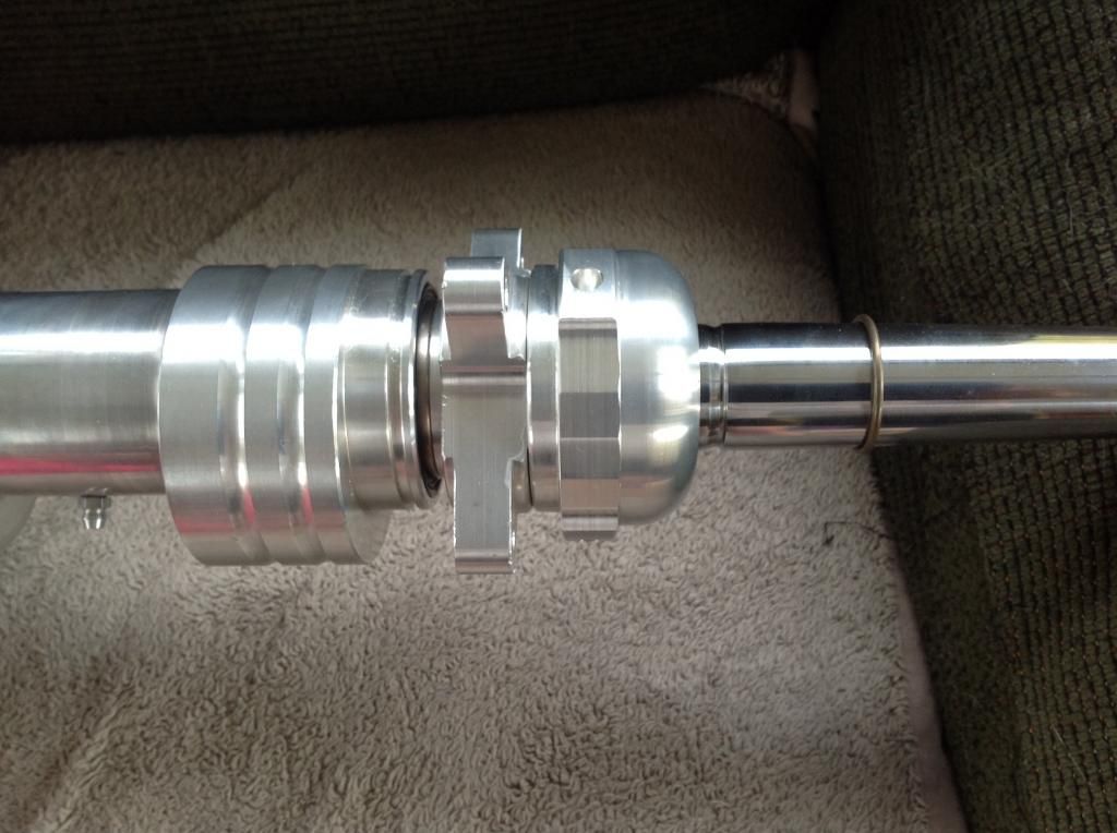

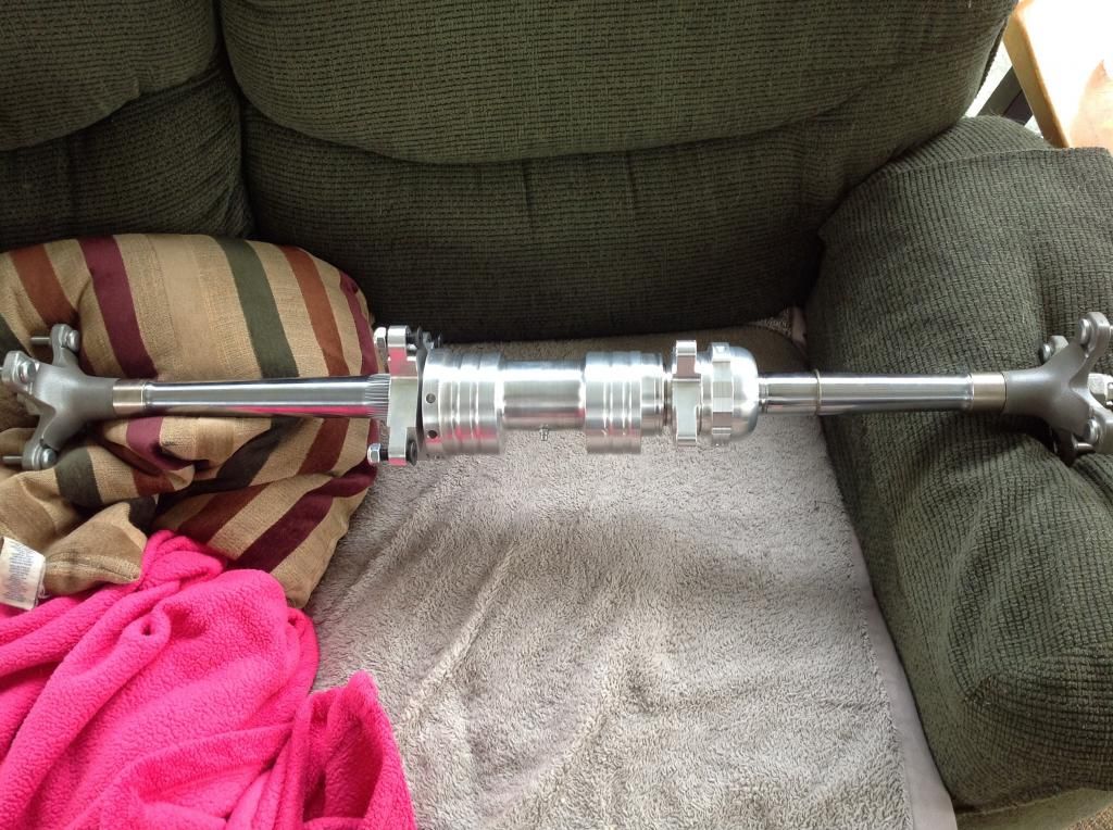

Will a 400EX axle fit 250R???
« Reply #13 on: January 17, 2015, 11:07:10 AM »
The 3/16 washer would be placed here? Would that effect where the bearing race and dust seal, would sit on the axle? I need to replace my LSR axle. Them new are taxing! The Tusk brand could provide.
