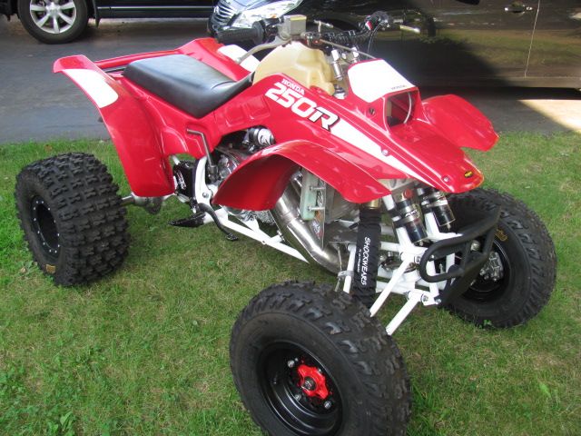

What's up guys? So I decided to possibly sell my R. I figured I'd head out to make sure everything's tight and take it for a spin first (it's been a couple months since I started it). I kicked and kicked and nothing... Checked spark and all is good, chokes up, tether is connected, fuel is on...
What I discovered was with the petcock on, the fuel doesn't trickle down. My first assumption was a clog in the tank or valve itself. I disconnected the hose from the carb and checked for flow once again - It flowed perfectly!! So the issues in the carb?
Any ideas on what to aim for when opening up the carb? Has this happen to anyone else? Thanks in advance.
Pic of the bike for kicks
