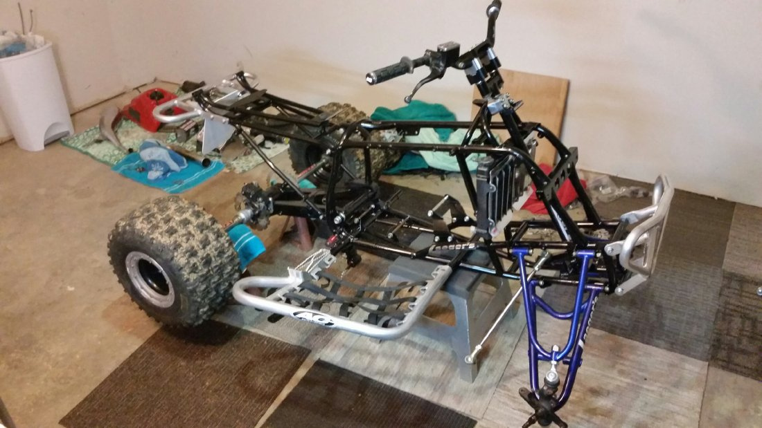

Not much more progress. Bumper and grab bar on. Tie rods and a couple hardware pieces should be here Friday to finish the linkage and start the front end assembly again. Rear end just needs tightened up but it's together. Set one of the nerfs on to see how it will look.
Offline PNWrider
2015 Season Build
« Reply #38 on: February 11, 2015, 12:18:42 AM »
Just noticed no rear motor mount by the swingarm. Is that normal for these frames?
Edit: I looked a little harder and found it, just the lower one
Offline zcarlson12
2015 Season Build
« Reply #39 on: February 11, 2015, 09:52:58 AM »
Ya it's there PNW. I've noticed a lot of the Laeger frames do not have the crossbar mount in between the vertical frame tubes that goes through the back of the cases. I'm not sure why though.
