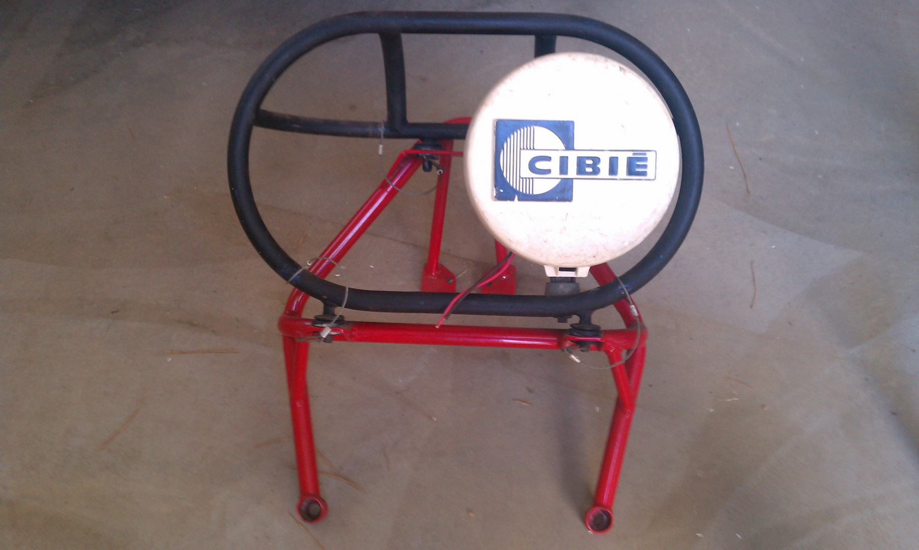

Scored a rare old HRC factory team Baja light from a new friend. It was used on the ATC efforts and then adapted to a team TRX in later years. The upper knobs allow the rider to adjust the pitch angle on the fly, per the flexible lower rubber mounts. Can't wait!

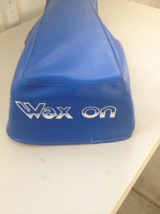

Also got a new (NOS) Wax seat for the retro Baja theme. Probably will be a while before I get to installing this stuff....

You know I want to see more pics of that beauty light bar and how it mounts. Nice score. At least show the back side. cmon cmon pleasepleaseplease

Keep in mind this needs a full restoration, but is in pretty good shape considering the abuse it's taken. Here is a top and bottom view. It has been modified from it's original ATC mounting to a TRX in later years. It's hard to see, but the bottom of the lights mount to a thick rubber mount, allowing for pivoting adjustment.

Awesome k10 I can't wait to see the rest of it. You know, the rack that it pins in to. I've fabbed up a couple myself so I'm interested to see how others have done it.

This light bar "pinned" into a bracket welded to the frame on the previous owner's machine. I'd like to go with a bolt on configuration. Do you have any suggestions from your experience? Pics possibly?

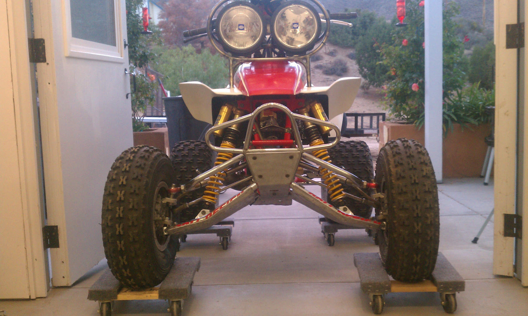

Unfortunately I didn't take any close up pics of the brackets I made on my latest version but you can probably get the idea.
I used to run a bolt on "rack" and pin the light bar in like the one you just got so it could be put on and taken off quickly. Then you ride around with a big ol frame on the front of your bike.So I made smaller brackets using the upper shock bolts to mount the rubber grommets to(I used radiator rubbers) and another bracket using the steering stem bolts. It's still a quick release set up just without the rack.
This one is untested tho. The other one proved itself in the Vegas to Reno a hundred years ago.
My old racing buddy Charlie Lamson had a Honda issue light bar just like yours and we moved the pins on it to mount on the red rack in the picture.

Okay, cool. THANKS for the photos!! Helps me brainstorm a bit.
What I'm thinking is,  I'll try going from top shock bolt to top shock bolt under the plastic with a bridge like brace bracket, and have the two pins on the light bar frame come down through the hood, and into the bridge brace bracket w/rubber cushions.
Down through the hood is how it was previously mounted on the seller's TRX. He just had a the pin mount bracket WELDED to his TRX's frame. I would rather not weld on my freshly PC'd frame or modify the light bar frame any further if possible. We will see though....?? I don't know if you can tell by my pics, but it's already set up to bolt to the steering stem block.
It's a project for sure, but I 'm sure it'll be reasonably easy. Thanks again, ytman!

« Reply #74 on: February 15, 2014, 07:33:51 PM »
