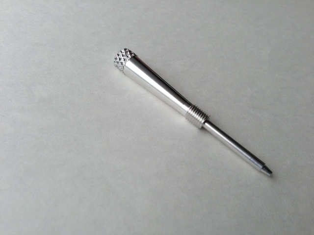

Replace your standard slotted air screw with a extend adjustable thumb screw version like this, this allows you to reach down and adjust the air screw without shutting the motor off or getting off the seat. The air screw makes a huge differance on the off idle performance. Once you have one you will always have one of these.
There are several companies that make them but here is a example of a extended adjustable thumb screw
