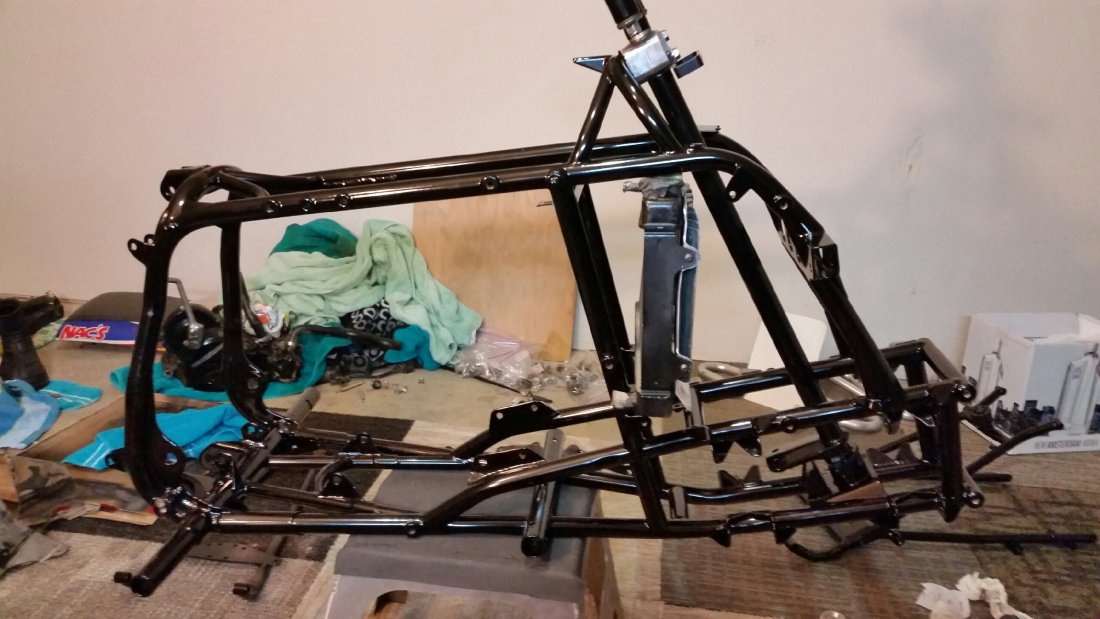

Looking for some pics of a Laeger or similar frame and lower front fender bracket mounting solutions
In this pic you'll see the mounts I currently have. But this is an MX frame and doesn't have the lower mounts.
Can anybody provide some pics or dimensions on what they use?

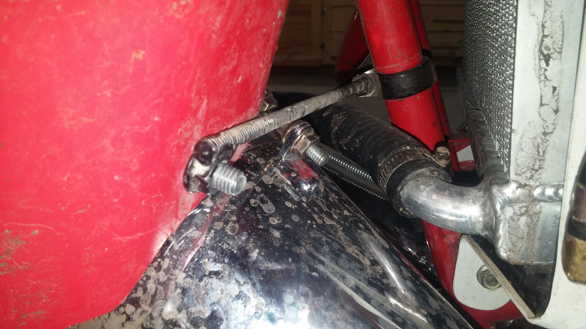

« Reply #7 on: March 12, 2015, 09:31:44 PM »
Just a piece of 1/4" all thread with a nut welded on and a clamp.

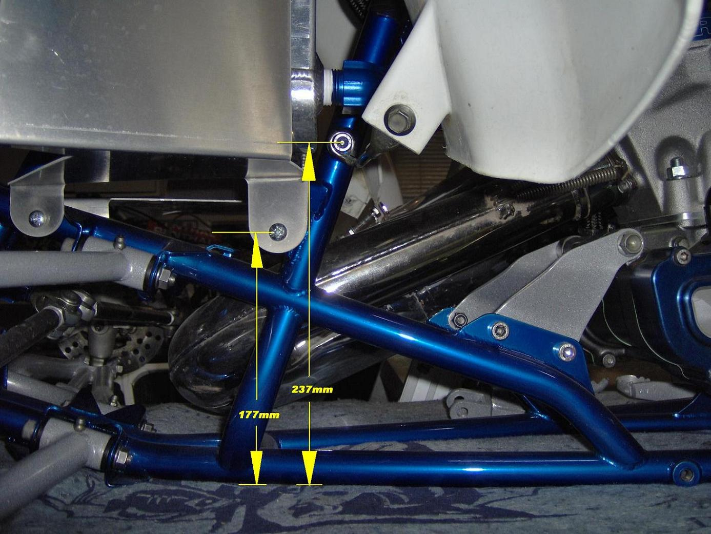

« Reply #8 on: March 14, 2015, 04:22:37 PM »
I use the STOCK lower fender bracket and it bolts to the frame....here's a pic with dimensions for locating it.

« Reply #9 on: March 16, 2015, 12:43:03 PM »
Quote from: Langbolt;51597
Awesome Langbolt that is exactly what I needed.
Thanks a bunch
