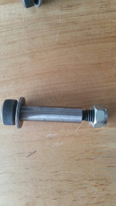

Thanks guys. I figured out the head of the bolt with an allen like you all suggested. The problem was the other side with the nut. I couldn't get a socket on the nut inside the tube. I ran up to the store and got a M10 shoulder bolt down to a M8 with a washer. I'll post a pic tomorrow.

What GRADE Shoulder bolt did you buy ?
Looks like a Grade 5 or less (mild steel)
You might want a Grade 8 or better if you JUMP with your quad!

Langbolt- I told him to give me the strongest one he had and he said they were grade 8. They do look weak to me though. We have plenty of the 300ex a-arm bolts and 250R nuts in stock here at work so I'm just going to buy a couple and if they work take the shoulder bolts back. Thanks for the help everyone! The joys of putting together a custom quad!
