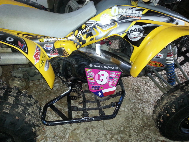

Well no issues this race. Just me not being as fast as I'd like. Got 2nd on the holeshot but gave that up half way through the first lap. Did 8 laps total, 90 minute race. Ended up 3rd overall. Just not real happy with the bike...yet. The lack of power out of the corners is kinda pissing me off. It was great at first because the track was wet from a recent rain. It really helps it hook not having it in the power band out of corners and is an advantage over the 4pokes. But as it dried out, it really hinders it. Yes, a 350 would help. But not in the budget...yet. So I placed an order with ESR for the high comp race dome and going to have the head milled to try and get up to 205-210 psi range. I think I'm sitting around 170-175 right now. Can't be certain because I haven't checked since the beginning of the year but it does have the pump gas dome in it. Got a new set of o-rings too. I already shaved down the trailing edge of the pick up on the flywheel to put some timing into the motor. Cleaned it up too. Can't say butt dyno can tell a difference but it seems to run cleaner. Bumped the pilot too from a 48 to a 52. Still having a hung throttle when pegged and it gets close to redline. I think that's due to me lightening the slide spring too much and it not having enough tension to snap it back down. Oh well. New dome setup for next race and I think I'm going to try jacking with the gearing too. May switch the PEP fronts for a set of TRX450's I have laying around and see if the extra stiffness helps.
