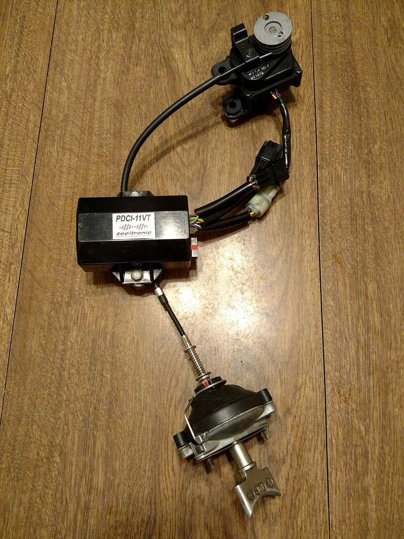

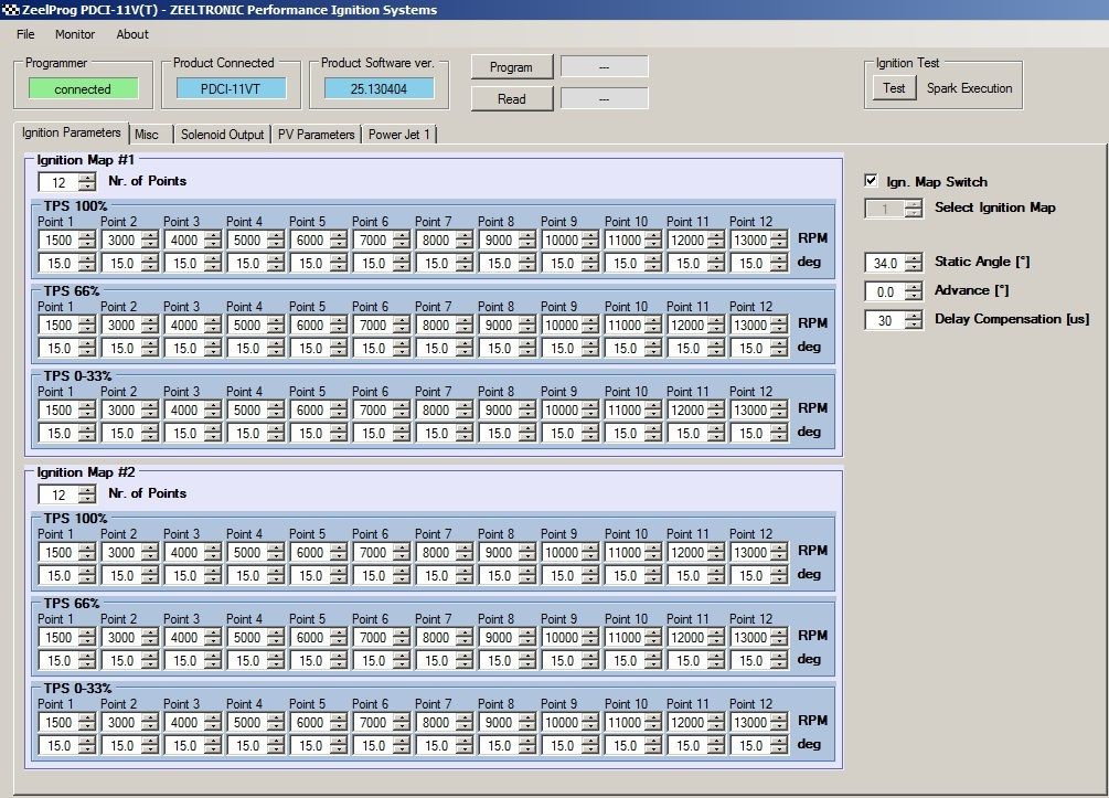

But here is what I have so far, I'm using an aftermarket programmable DC-CDI with integrated powervalve controller. This allows full customization of the ignition maps, PV maps, TPS input, rev limiter, power jet solenoid... you can even mount a switch on the bars to toggle different ignition/PV maps (think holeshot setting...) pretty cool stuff!
Wish I had more time to finish and test, hopefully someday I'll have a ride report.

Wow!  This is cool.  On first look, it looks like an RZ YPVS servo motor, and a modified rotax powervalve.  I have an RD350 also, so I know a little about that system, and zeeltronics.  This is very cool.
Please keep us posted if / when you get further.

The Zeeltronic units work really well. I have used them for years on road racers and custom projects. I just have not had anyone that had a Honda big bore that was willing to spend the money for the Zell controller, stepper or servo actuator and the necessary hardware to make it work on the pneumatic type power valve. You are also going to need to spend half a day or so on the dyno mapping the ignition and power valve curves.
