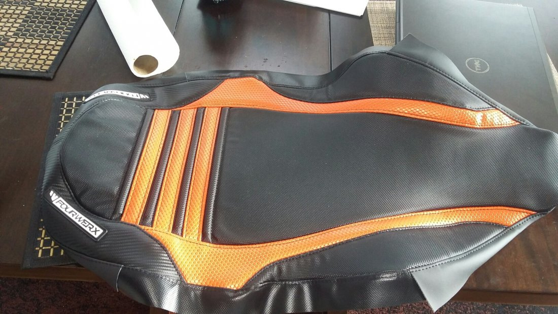

« Reply #102 on: January 23, 2017, 06:06:15 AM »
new seat cover.
