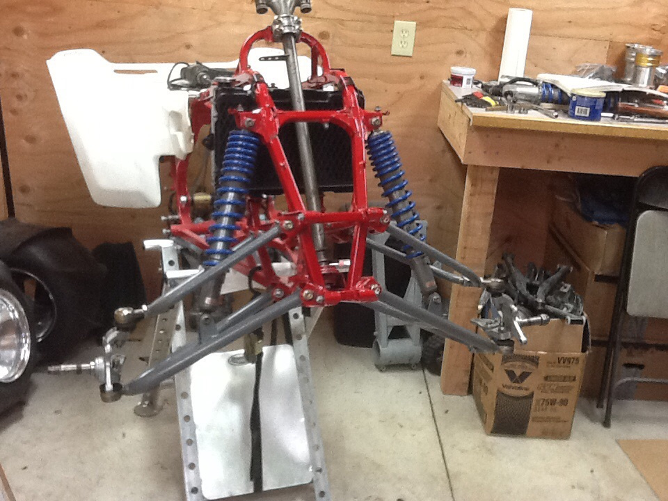

We picked this 86 up 2 years ago from the 2nd owner. It was last tagged in 05 & just sat in a garage covered in sand & years of grime. Doing a basic stock rebuild & left all the original coatings in tact because they were in good shape & I want this to be a rider & not a blingin dune bike like mine. It's a pain to keep everything shiny. The engine, swingarm & a-arms have been off this bike before, other than that I'm the first one to ever completely tear it apart & turn it into a lifesize exploded view. It's a nice survivor:

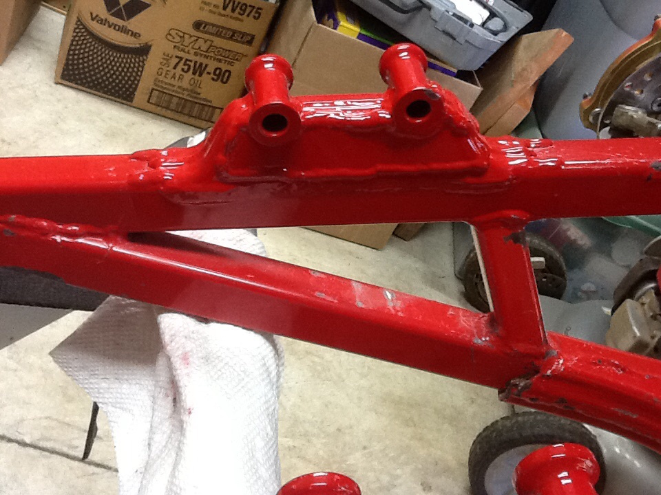

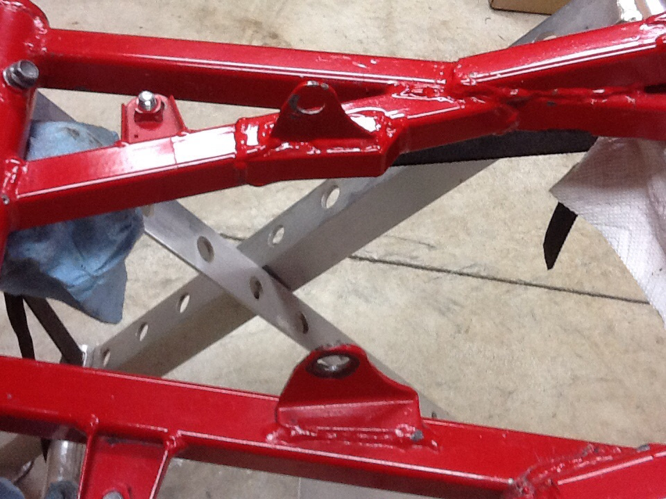

Found a couple cracks on the left front & left lower engine mounts. I drilled the cracks & plated over them with 16ga:
added support under the lower mount

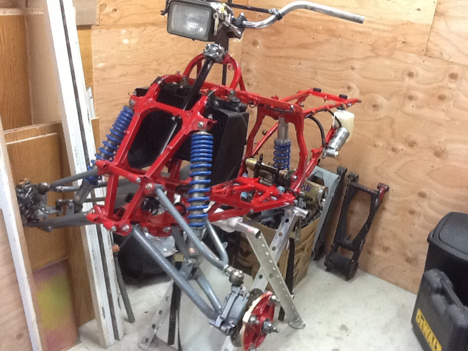

Reassembly, my wife liked the red better than the blue so red it is:
Finished the calipers & both MC's today & got it on the ground (been on the stand for a year & a half) just need to bleed the brakes, torque the rear suspension bolts & put the engine back in. Getting close..... Braaapppp!
