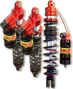

Hey everybody, im currently running +2 lonestar std arms, works shocks with rezzies (practically brand new), and a stock rear stock (unsure of history). I ride alot of different terrains mostly fast paced, 60% desert  , 30% MX, and 10% woods(wide trails). Im sitting right at 47" with this setup with 3/2 rims. Id like to order some JD Performance +3 arms to get me close to 50" to match my rear. Since I see it is only $100 more to upgrade to long shock arms, I figured i may as well upgrade. Im currently happy with my works but if im going to have to send them out for a revalve i figured itd be better to just get some long shocks that have more adjustability. I am however not happy with the rear shock, it bottoms on any big hit on the track or in the desert.
So I see the Elka stage 3 package on many websites and it looks like a good deal for getting front and rear shocks for $999.99
Ive read reviews of people either loving or hating elka. Im aware there are better shocks out there but im not a racer just looking to go out and have fun but also get good performance. I wanted to see what everybody thought before i start ordering stuff.
I appreciate the advice

I can assure that the jd arms will impress u. In my opinion Elka are better than works. I removed st works to pit on lt elka and am very impressed. I do not have jd arms on any of my R's but I do have a set on my 450. Also I suggest you do  the needle bearing upgrade. Adjusting camber/caster is so easy with the jd arms. No removing to adjust. I have heard of people complain about powder quality on the arms but mine have held up great.

Totally agree on the long travel. Doesn't cost much more to go that route.  The Elka legacy series is a heck of a deal but personally I'd go with Motowoz, fox or the higher end elkas. The set up and customer service u get with Jim is far above Elka Imo.
Still a heck of a deal though.  Hard to justify the extra cost. Any other set up new is probably going to be at least 1000 more.

My next question is do they actually set up the elkas for the riding style or do they just send them out with generic valving? Lonestars website asks for weight, terrain and rider class but I remember reading someone saying that they just send them out with the same valving.

Best to call and ask Elka. My understanding is Elka sets up all of them specifically to order. Call and ask JD what shocks they recommend as well.

I have a email into JD and he thinks the elkas would be a good choice for what I plan to do. I'll give Elka a call monday

When elka had the $800 front and rear set sale going on a year ago I got three sets. One set per quad. I ordered directly from elka in Canada instead of a third party like ATV galaxy etc. Elka asked a lot of questions and also had a huge data base that was in line with extended and compressed length along with leverage ratios.  I had took the time to remove shocks and go thru the steps Andy maul had posted on maultechatv. Also talked with all my a arm manufacturers for the proper leverage ratio before calling elka and all the data they had was exactly what I had. I am happy with the set ups.
