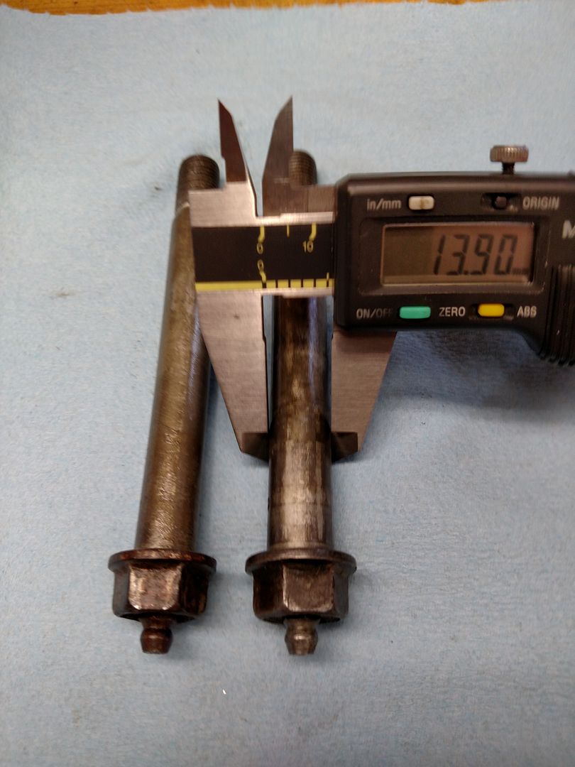

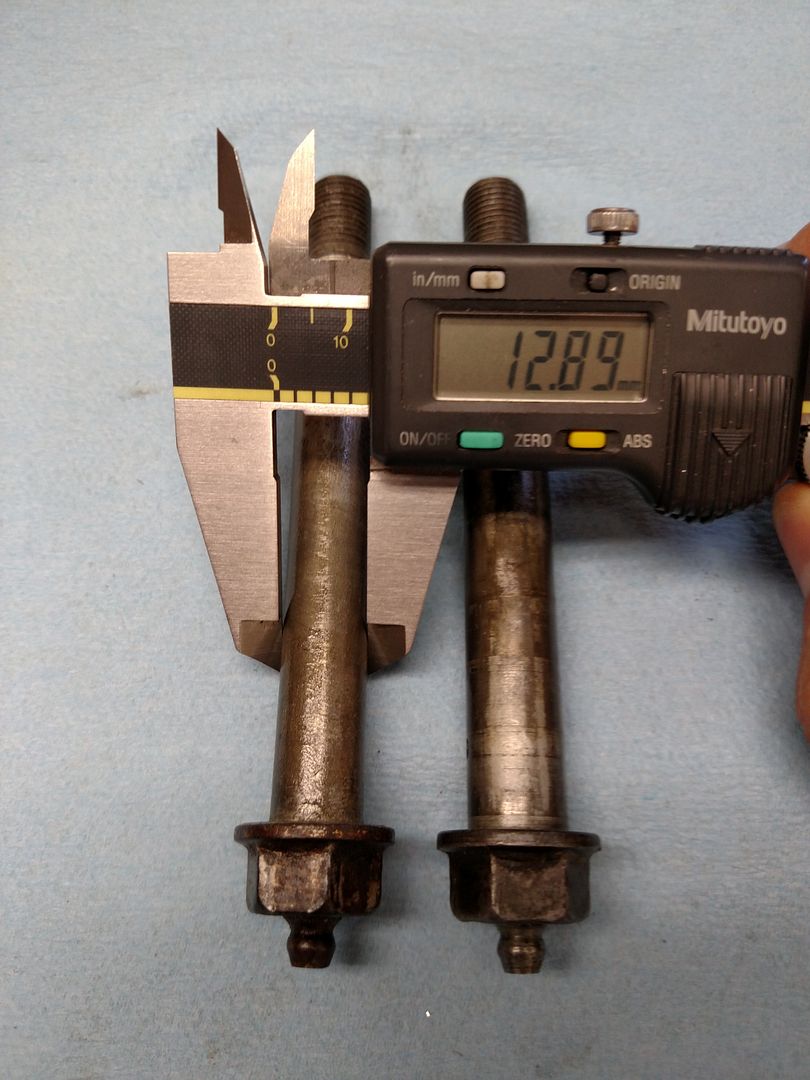

The ATC shock linkage bolts (85 and 86) are 1mm smaller than the TRX bolts, hence the TRX linkage bushing kit wont work on an ATC. What I did on my 85 was use the 86 TRX linkage and bolt and enlarge the lower shock clevis hole to fit the larger bolt.
