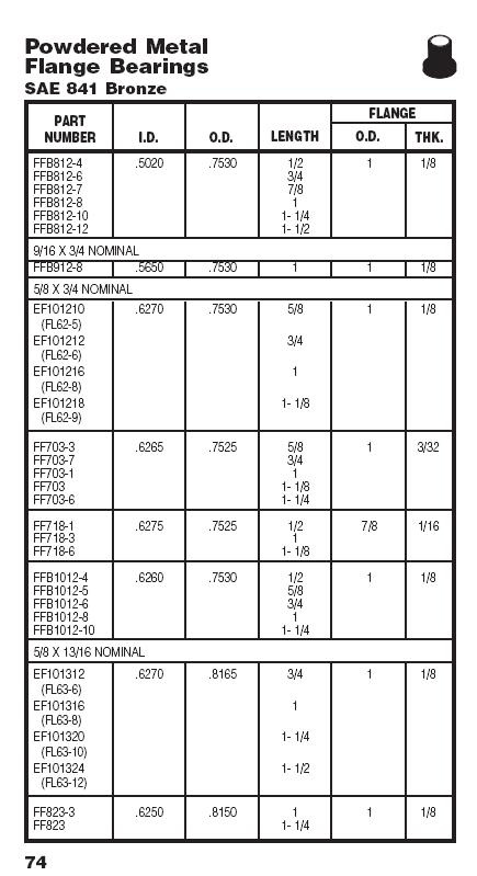

If you can measure the ID of the A-Arm....and the OD of the crush pins....you can find the size in the Bunting Catalogue......any Bearing supplier can get them and they're very cheap.
Here's an example page of the Oil Impregnated Bronze Flange Bushing

There's more to a bushing. ID,OD x2, shoulder width and OAL

Hate to say it but bearings are this way as well.

Oil impregnated bushings never last from personal experience in the working world a solid bushing with grease fittings last longer.
