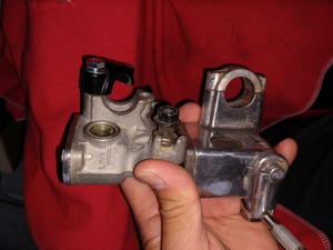

Top is a CRF. Bottom is TRX. Notice the TRX has a much thicker mount for the handle bars. This thicker mount is so the master will clear the throttle.

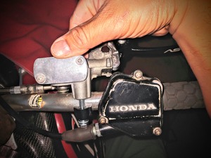

Here is a picture of the CRF master on the bars. Notice the master is touching the throttle. Also the brake line is touching the bars. Clearance needs to be made to properly mount the CFR master.
But how you ask? The solution is simple.

Notice now with the spacer installed the CRF master (bottom) now has the same mounting distance as the TRX master (top).
