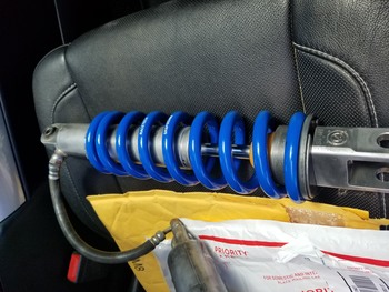

I just wanted to share with everyone that there is a suspension guy located near Longview Washington. His name is Craig Bowman (CB Racing). Craig has been building suspension for the local MX guys for 30+ years.
I just had him build a rear shock for my R and it turned out fantastic! Let me know if you would like his contact information.

Offline ajbuilder250r
Re: Shock rebuild
« Reply #5 on: August 04, 2020, 10:56:25 PM »
I'd like his contact info.  What made you select a different spring?  How did he determine the spring rate?
Offline The norm
Re: Shock rebuild
« Reply #6 on: August 04, 2020, 11:48:44 PM »
After I bought my R in 2012 I lengthened my swingarm. The shock I had was set up for a rider 100# less than me and for a stock 86 swingarm. I told Craig how much I weigh and the swingarm length. He determined what spring I needed. This Monday will be my first opportunity to try it out.
Loren
Offline The norm
Re: Shock rebuild
« Reply #7 on: August 24, 2020, 12:26:21 AM »
So I spent a week out in the dunes with my newly rebuilt OEM rear shock. This shock has a totally different feel than the shock that I was running before. Craig Bowman did a fantastic job. The rear shock soaked up a lot of whoops and the jump landings. I am not much for big air anymore so I don't know how it would take a 10 footer with 285lbs of man on board,  but the modest air I did get tested the shock and the performances was perfect.  When launching during some drag racing the rear of my R didn't squat that much and felt planted.
Overall I am very happy with my $430 rebuild and would recommend CB racing suspension to anyone.
