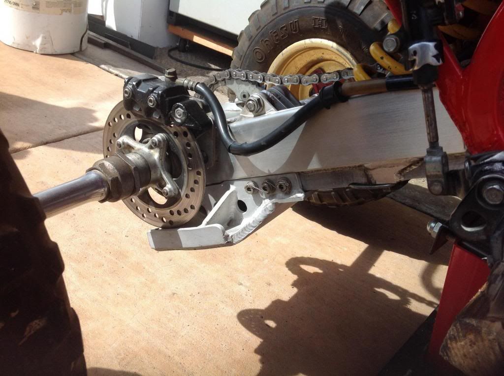

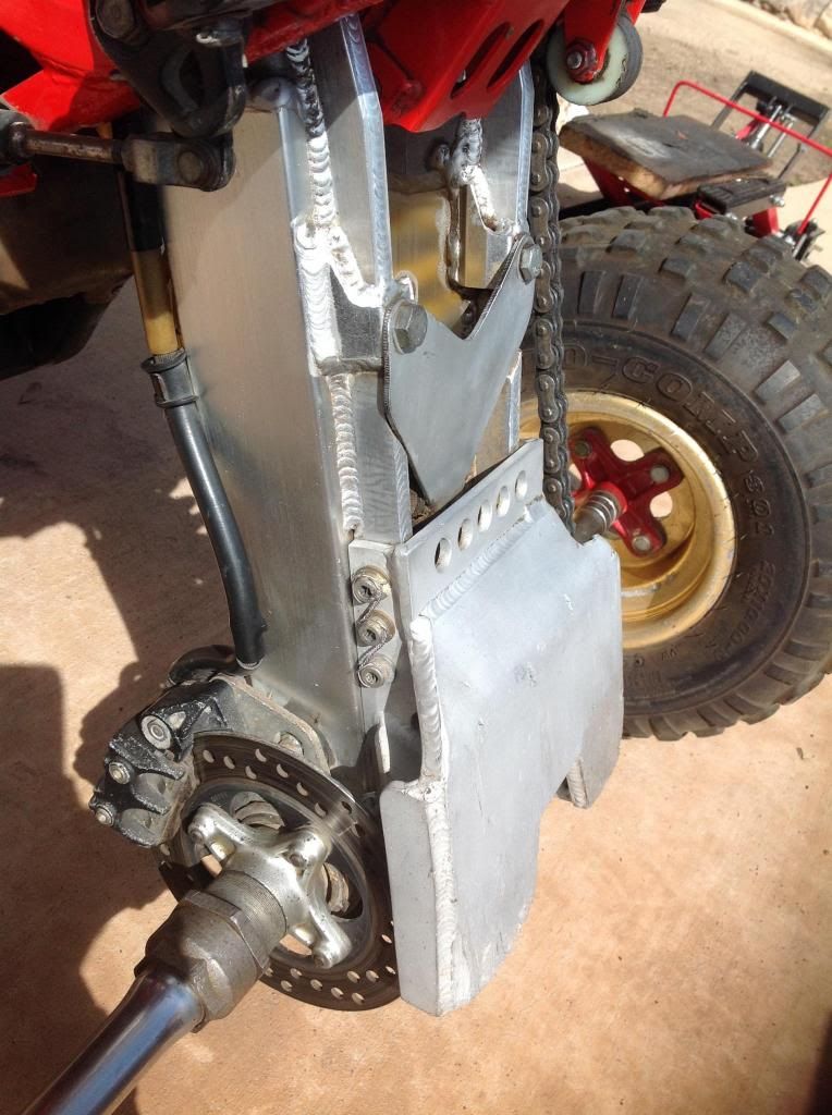

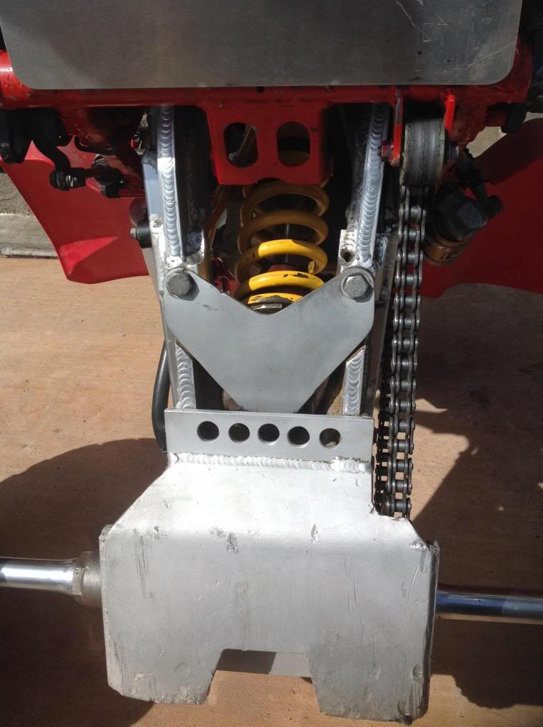

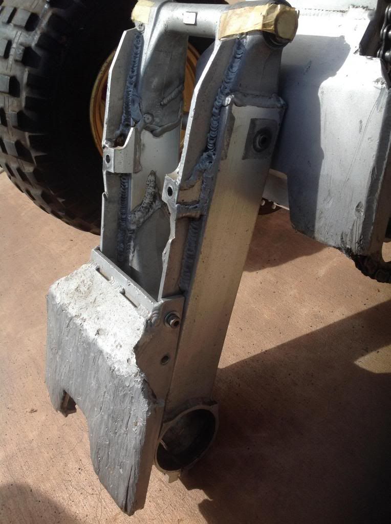

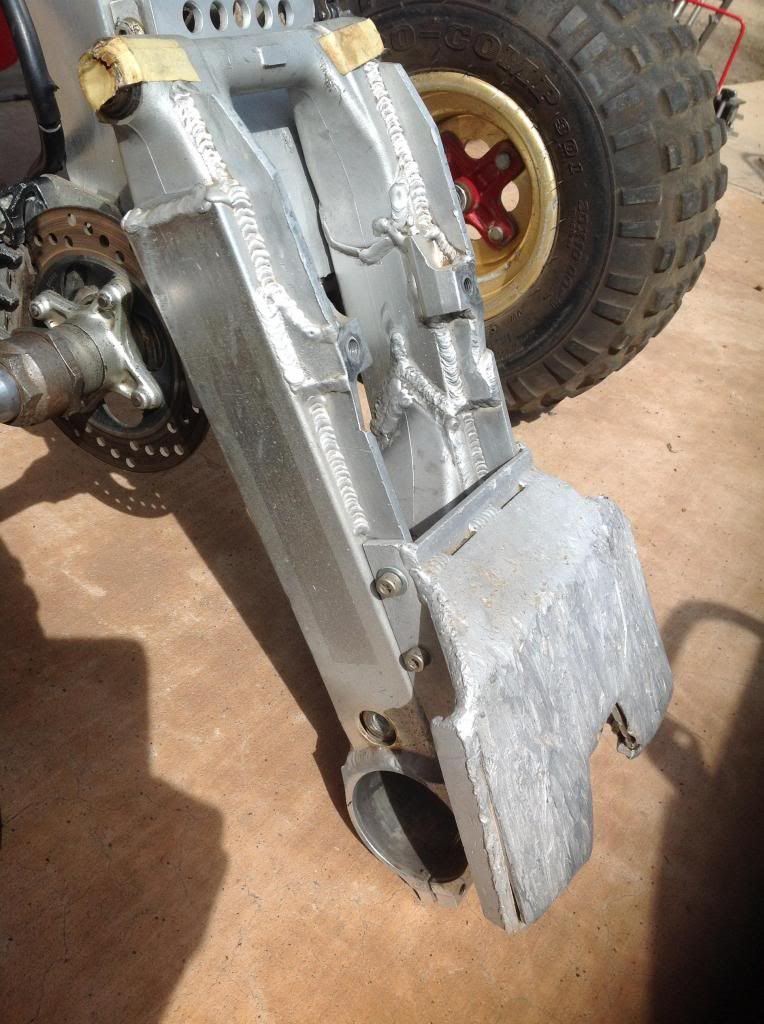

Got me motivated
Here's the pics
There's the first rendition off the atv then there's the second installed. You can tell the first rendition was ran for awhile, the 1/2" bottom (two 1/4" bottom plates) is separating from miles & miles of rocks.
The one has 1/4" gusset plates welded in, which lasted a couple years before I had to chase the cracks. The other has two 1/4" plates welded in and a more durable skid plate. Had to upgrade those forward mounting bolts 10 x1.5

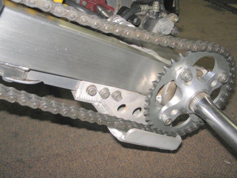

« Reply #10 on: March 18, 2021, 04:33:43 PM »
Frisk link eliminator pics.
