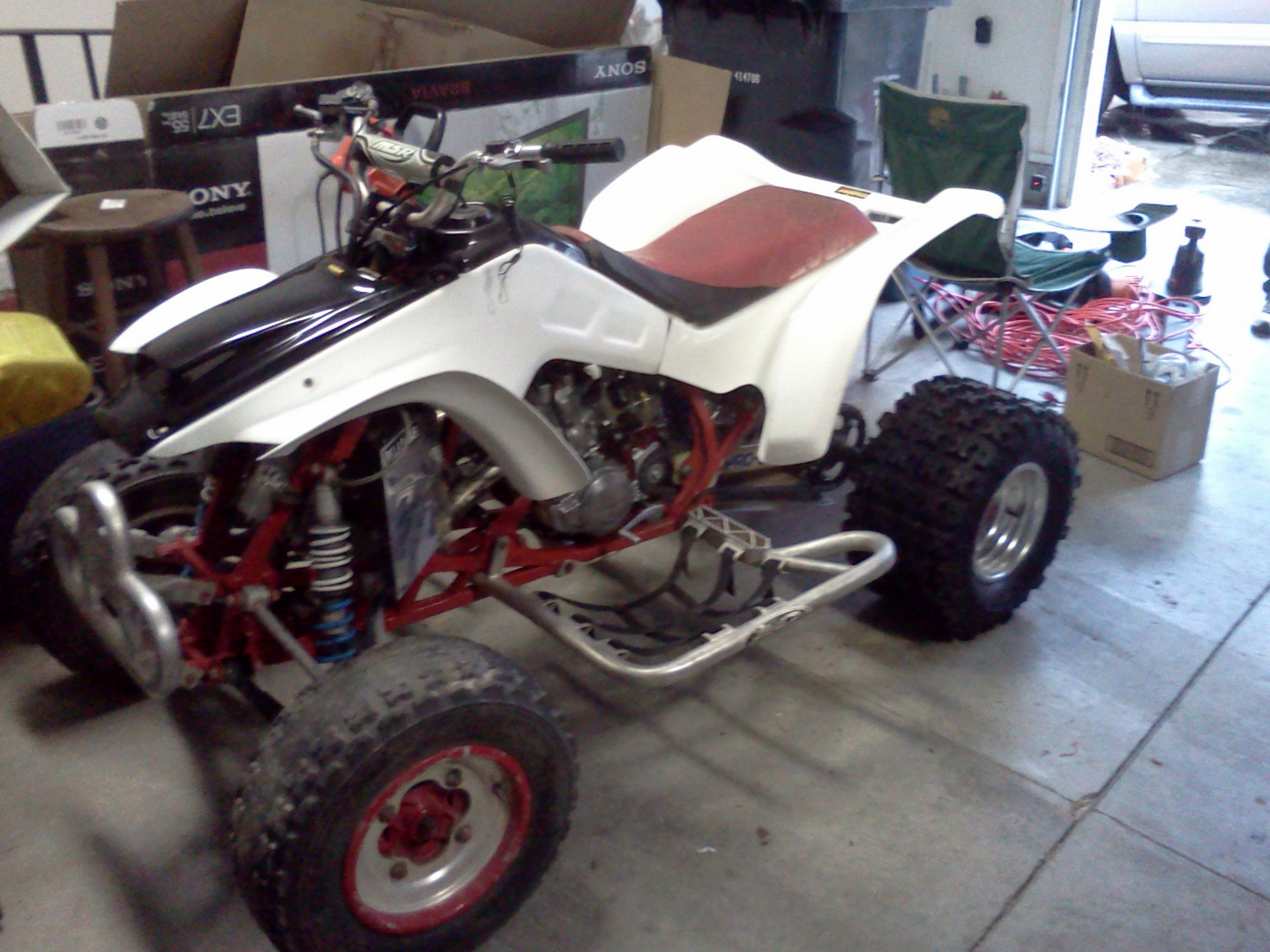

« Reply #29 on: December 15, 2013, 12:19:57 PM »
Here is how she is sitting now.  I'll be ordering a black seat cover and front tires after Christmas.  I will clean up the front rims and get the spray paint off before the new tires go on.  Still have some parts that have to go on.....LSR antifade, front stainless braided lines, water temp gauge and rear brake system.  She will be a rider as is until I get my Suzuki done, then I'll tear it down for powder coat and figure out what I'm going to do about the front suspension and rear shock.
