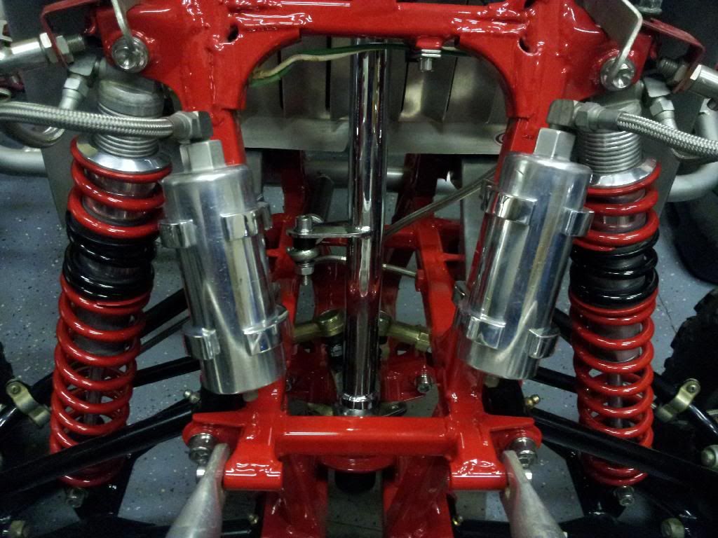

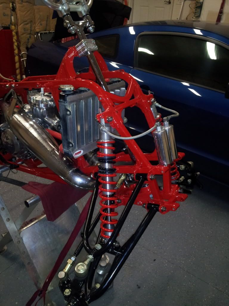

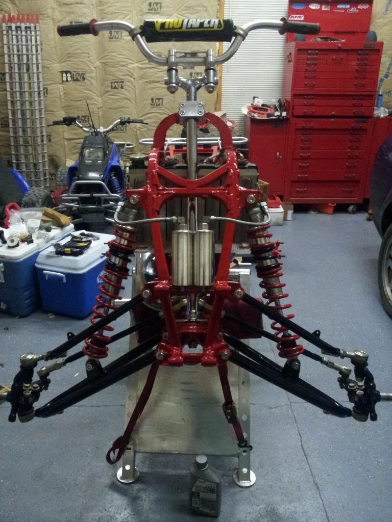

Got the shocks cleaned up and re-assembled.
Started bolting up the front-end.  One of the stainless shock mounting bolts seized up and now I have to cut it out. :mad-new:

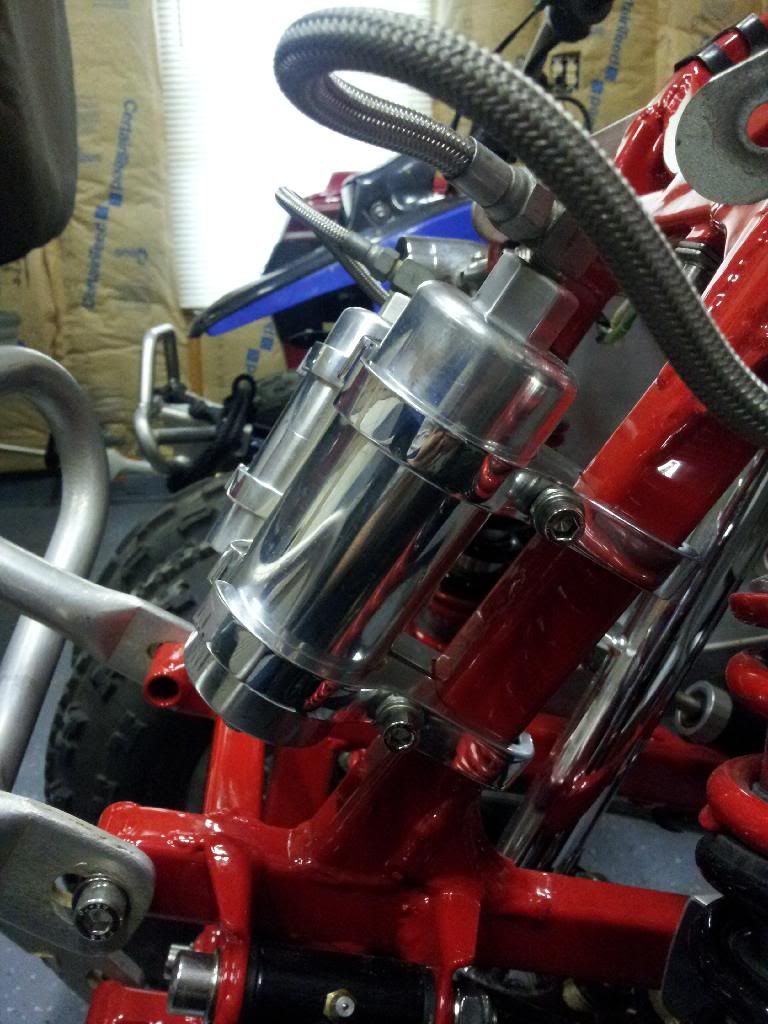

very nice job.  the polishing is done well.
whats the reason for the upper shock relocation bracket?
Offline Turftamer
'86 TRX250R Rebuild
« Reply #24 on: December 06, 2013, 08:38:07 PM »
Quote from: jcs003;19280
To be honest, I think it was just a result of the shock being too short.  The previous owner did most of the modification and I think it was simply a matter of using what he had available.  I'm sure it's not the best setup, but for the type of riding I do (mostly trail), it works just fine.

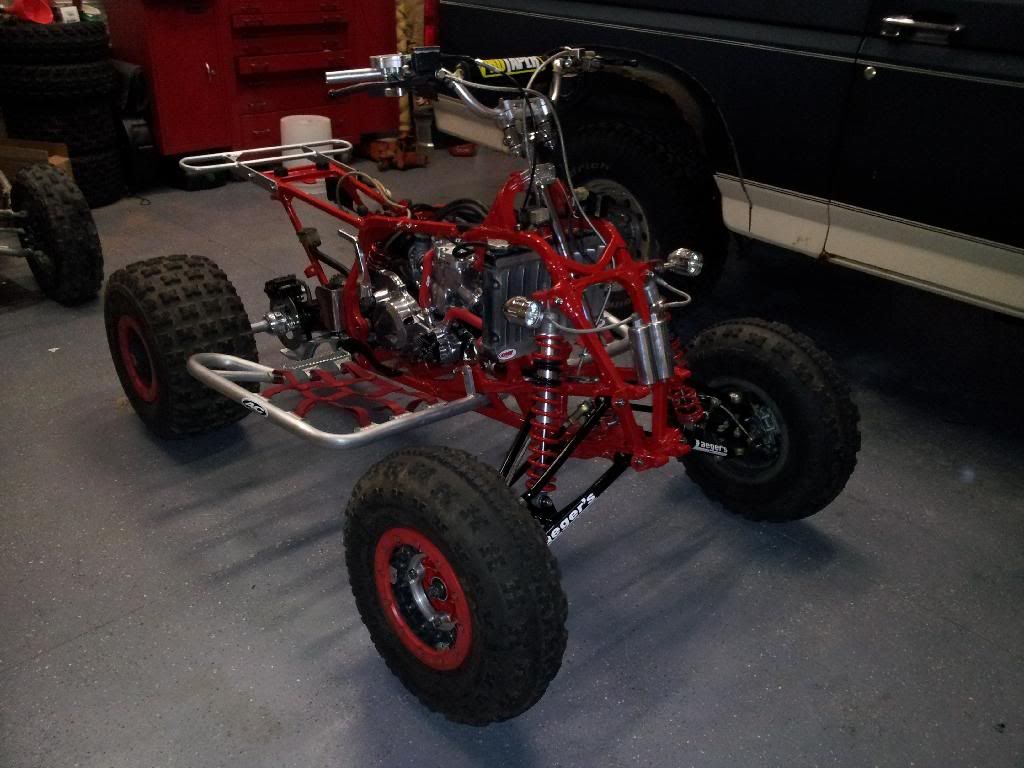

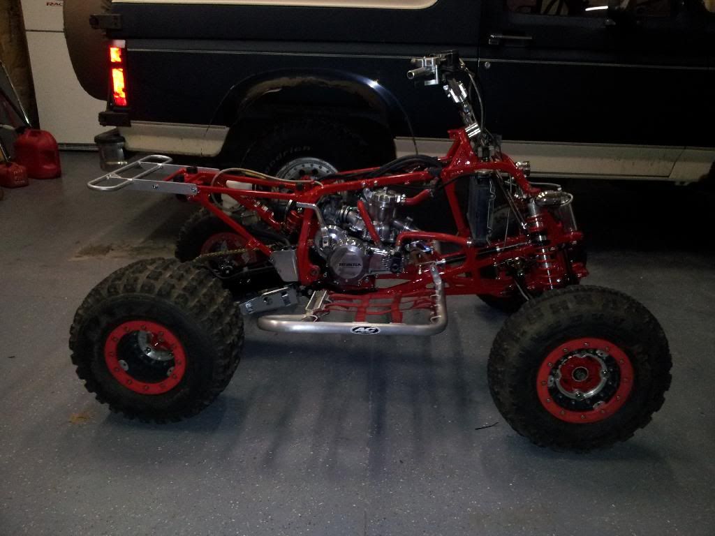

« Reply #25 on: January 12, 2014, 08:35:32 PM »
I promised myself I'd get it on the floor by Sunday night - mission accomplished!
Offline bnau267
'86 TRX250R Rebuild
« Reply #26 on: January 12, 2014, 08:44:05 PM »
Quote from: Turftamer;19288
I think they could have to do with using the trx450 rear end.  I bought a complete 06 setup and it seems like I'll need to mess with the linkage and shock mounting location to get the geometry as close to the original Honda design as possible.  I could and might be completly wrong but that's my guess...

Offline Turftamer
'86 TRX250R Rebuild
« Reply #27 on: January 12, 2014, 08:53:13 PM »
Quote from: bnau267;22114
NICE BUILD!
Thanks.  I'm almost positive you're correct.  The rear shock overall length is about 16".  I'm not sure what a 450R shock length is, but I think this is the complete rear setup the previous owner took off his son's 450.  A longer shock might help, but I think the lower linkage to frame mount would still need modification.
