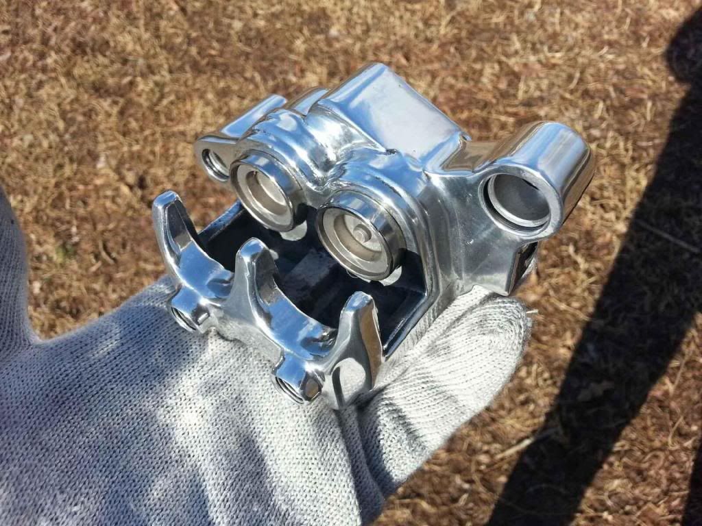

« Reply #1 on: January 12, 2014, 06:37:49 PM »
Ok so heres a photo of where the piston pads/inserts go. I'm looking to buy some of these pads/inserts, my old ones were junk. Any help locating these would be great!!!

« Reply #2 on: January 12, 2014, 10:19:08 PM »
They are made of cork or something like that correct? Good luck finding them. I believe that stuff is disc'd. Our calipers are made by nissin. Maybe parts from another caliper will work?

« Reply #4 on: January 13, 2014, 09:31:36 AM »
Higgy, those fiber discs only came with the caliper pistons, the rear pistons are no longer made. If you need new fiber discs you would have to buy front TRX250R caliper pistons and pry them out. I know for sure I have one used fiber disc laying around and could find another if you really need them.

Ok, so I guess my question is this. DO I REALLY NEED THESE?? I guess I could use a nickel, cut up a clipboard or possibly find some used ones? Problem is that I need 6 of them. Its looking like I'm gonna go without!! I just wonder if the heat transfer is an issue? I read somewhere that it created problems and the rear brakes were failing on some people!

« Reply #10 on: January 14, 2014, 11:03:34 AM »
Im sure it does have some heat transfer benifets, but honestly, will it even be enough to be noticable? I believe 400ex's still used them, obviously different piston size though. I can check my 450r and see what it has, it was all original when I got it, and I know the pads are original, and shot..lol.. Im sure they are also there for noise control as well, keeping the squeezing pads sound down.

 I think that both of these maybe good ideas. If I could just buy a 450r part that would work and be any easy solution!! Or possibly another company makes something for this application. I think that your correct, I'm sure it does act as a cushion and keeps the heat transfer down. Either way I wanna put something in there!!
