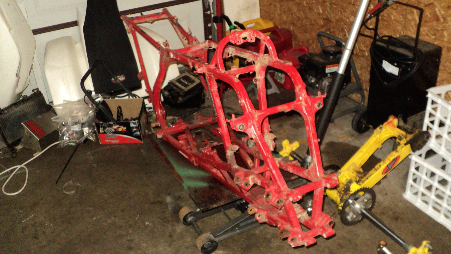

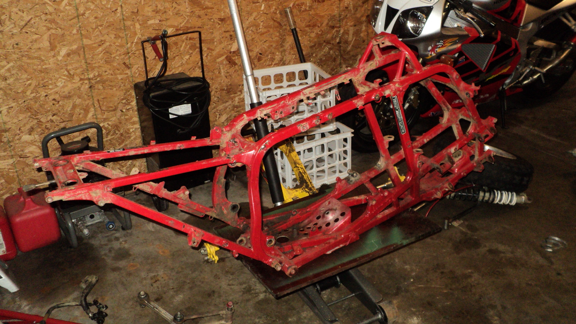

Well, I got her down to the bare frame this weekend! I could not believe the swing-arm pivot bolt came right out with just a couple taps with a hammer and chisel LOL! The a-arm bolt were another story. I had to use my cut off tool to get the bolts off. They had rusted to the collars inside. Now I just need to get her to the sand blaster, get ahold of pumashine for his best gusset kit he makes for the 86 and then weld that in, then off to the powder coater!

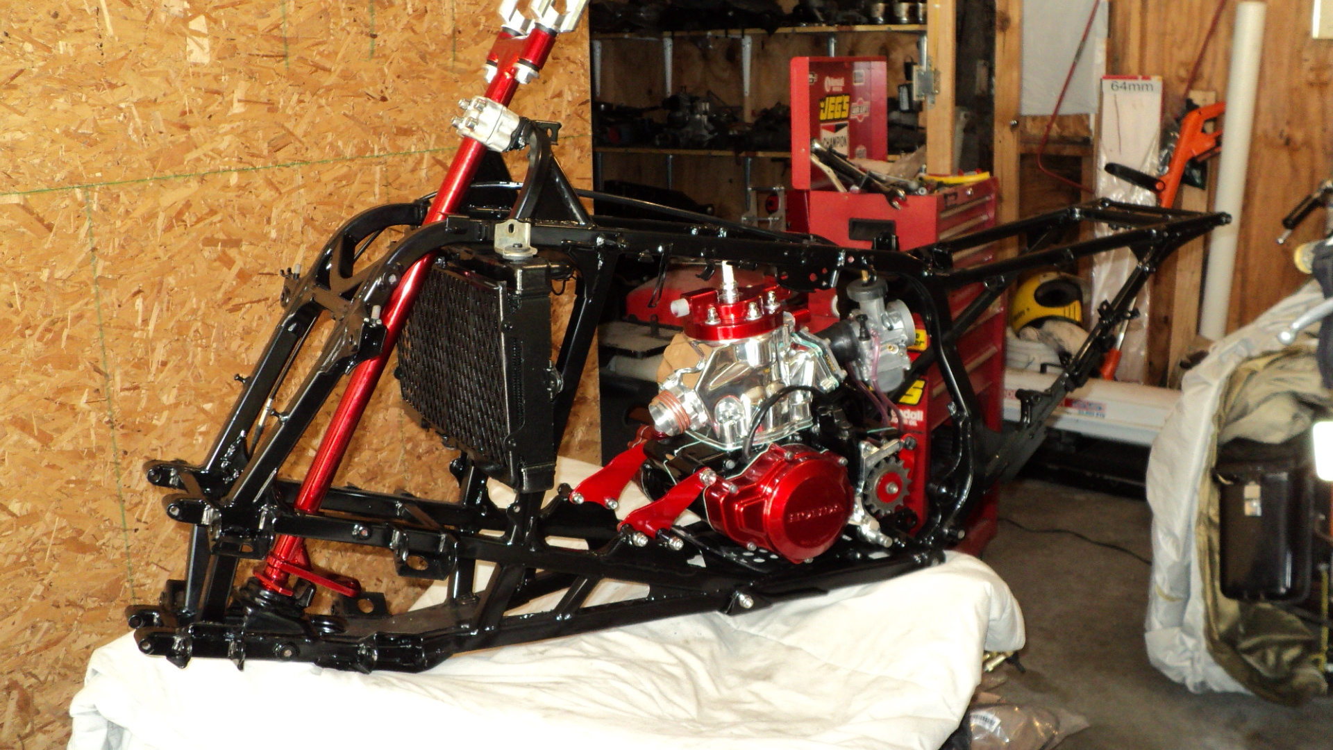

Happy 4th weekend everybody!!!! Sorry for the delay in updating my post but here are a few current pics. Got Tony's gusset kit welded in, got the frame powder coated. Had to send back the Lone Star DC-4s, and the Lone Star swinger back due to damage from shipping. Have not got them back yet. Here is how she sets right now.

looking great, i love the red clutch and stator covers.

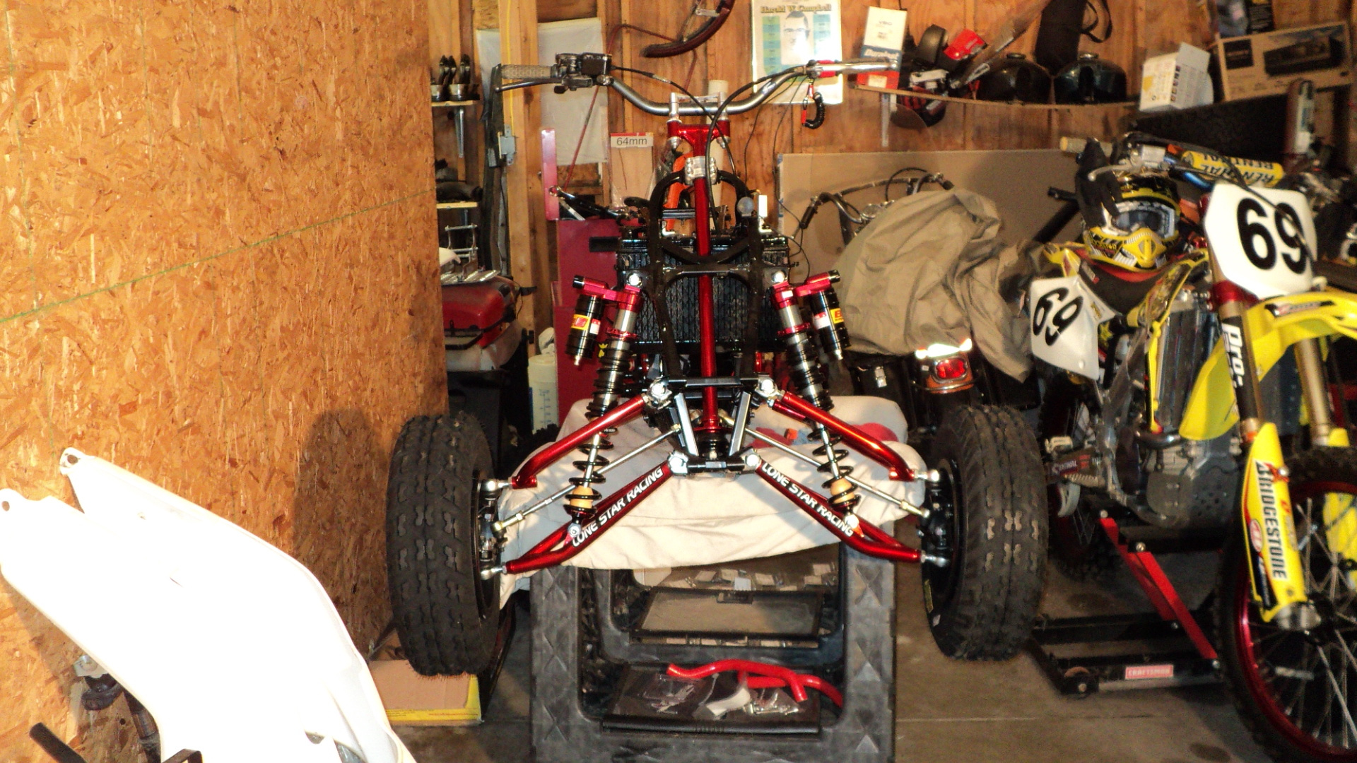

Got the a-arms back and they are a lot better than they were. Still a couple of blemishes but no major dings. Here are a couple of pics of how she is coming together.
