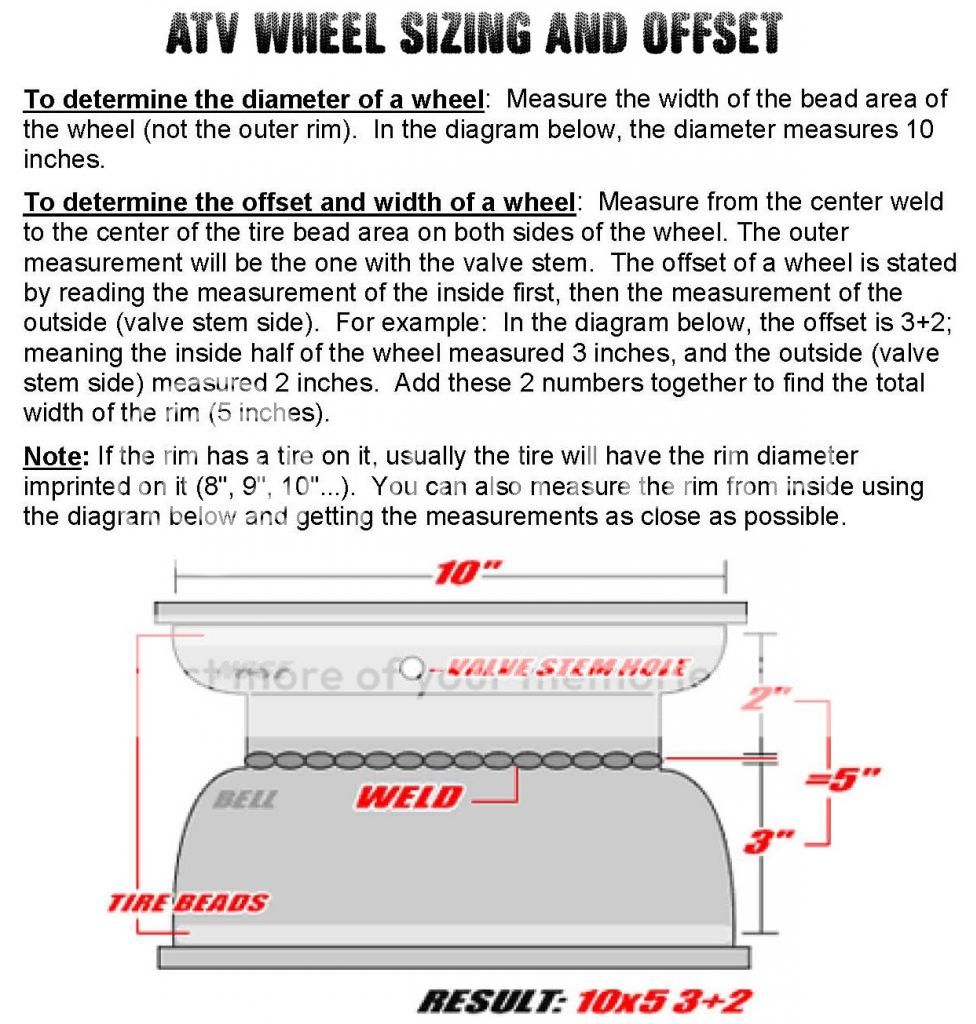

So what exactly do those numbers mean? The higher the second number the deeper the dish for wider stance?  I see the tears are 3+5
Front wheel offset
« Reply #3 on: January 25, 2015, 09:38:59 AM »
Nice reference page.
