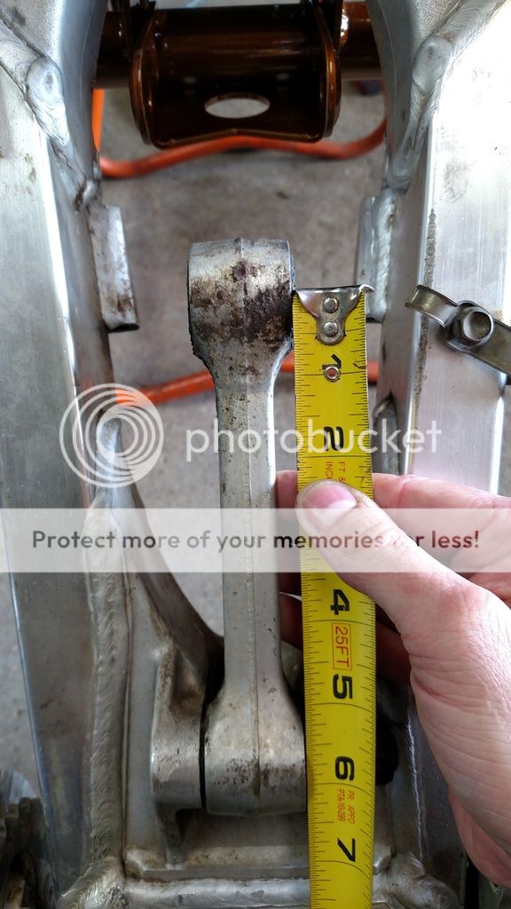

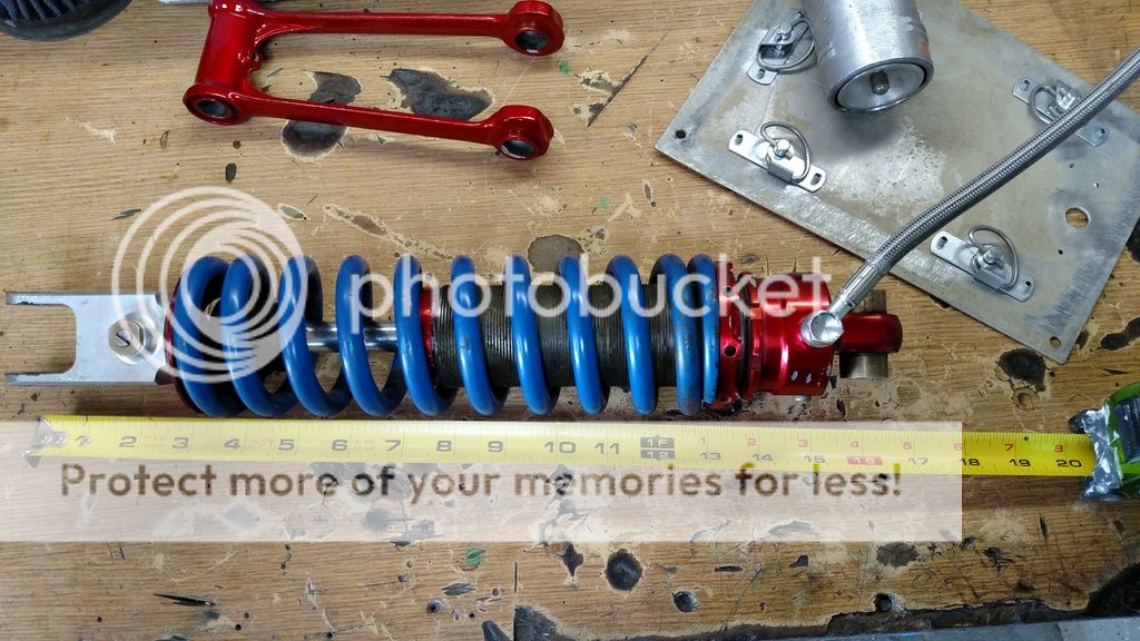

You just described either a shock with the rebound set way too fast or a suspension with a jacked up leverage ratio.
When you are checking it tonight, take some pics if you could. That would help us determine if you have the correct linkage components as well. Along with measuring the eye to eye length of the shock, measure the eye to eye length of the rear dogbone too. Again, if you can.
Also, check the rebound screw on the shock and see how many turns out it is. That will tell us where the rebound is set at also.

« Reply #23 on: April 13, 2016, 05:07:33 PM »
Ok here you go
aftermarket link
« Reply #24 on: April 14, 2016, 08:13:59 AM »
It looks like all your components are correct for each other. At this point, I would say this is an Elka problem. If you adjusted the rebound from as fast as it will go to as slow as it will go and noticed no difference, then something is wrong. And I don't think that it is preload because your ride height is where it needs to be. I think it may be time to send the shock to a shock builder and get them to investigate the problem.
