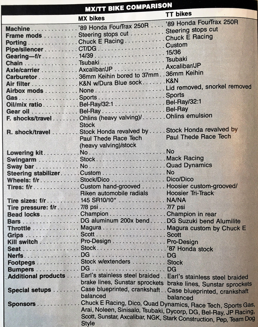

Original Specs vs Replica Specs
Machine................. '89 Honda Fourtrax 250R
Frame mods........... None
Porting.................. Chuck E Racing
Pipe/silencer.......... CT/DG
Gearing-f/r............ 14/39
Chain.................... Tsubaki
Axle/carrier............ LSR Axcalibar/LSR
Carburetor............. 38mm Keihin Air Striker
Air filter................. K&N/Dura Blue sock
Airbox mods........... Lid removed
Gas....................... VP C12
Oil/mix ratio........... Bel-Ray 32:1
Gear oil.................. Bel-Ray
F. shocks/travel....... Ohlins (Race Tech revalve)
                               Stock
R. shock/travel........ Stock Honda (Race Tech Gold Valve)
Lowering kit............ No
Swingarm............... Stock
Swaybar................. No
Steering stabilizer.... PEP
Wheels: f/r.............. Stock/Dico
Tires: f/r................. Riken/Carlisle custom grooved
Tire sizes:............... 145 SR10/10  18x9.5-8
Tire pressure:.......... 7/8 psi
Bead locks.............. Champion
Bars....................... DG aluminum
Grips...................... Scott
Kill switch............... Pro-Design
Seat...................... Stock/Ceet '89 style
Nerfs..................... DG
Footpegs................ Stock w/extenders
Bumpers................ DG
Additional products.. Galfer stainless steel braided brake lines, Sunstar sprockets, EBC brakes, TDR reeds
Special setups......... Every part of this bike was either rebuilt or restored
Sponsor................. Wife
