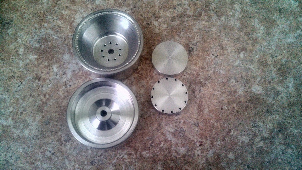

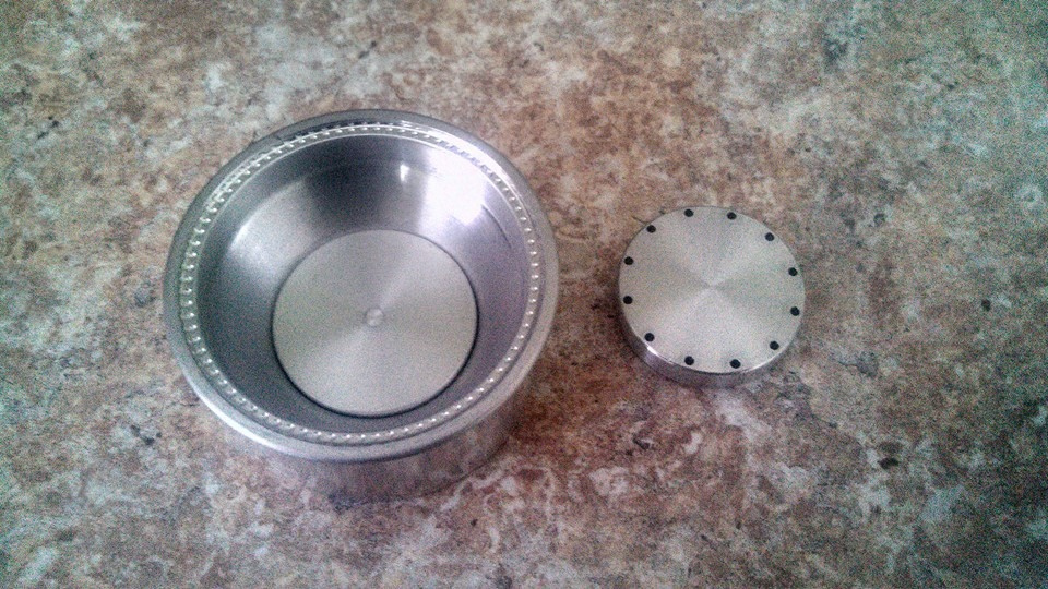

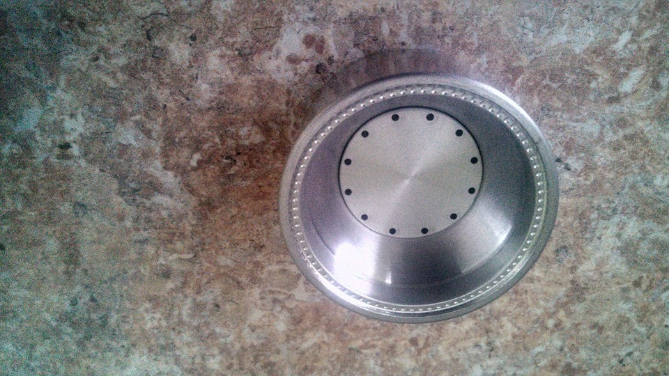

Any body use one of these polishers? I have one as of now just have walnut shell media that came with it. We get small shifter lever cut from 6061 or 5051 .040 thick aluminum cut with a water jet. The pieces are about 1/8" wide and 2" long there is some etching from cutting on the polished surface and cutting marks around the out side. What media and step could I use to do all the de-buring and polishing to cut out my labor. We have Aluminum wheels and fuel tanks CNC made too that we polish with a buffer along with stainless exhaust stacks machines. An help would be great. I posted some of the things we do. Thanks
