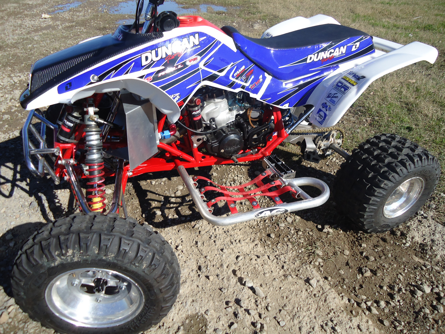

Nice looking R!

very cool 250r.  details on your engine please.

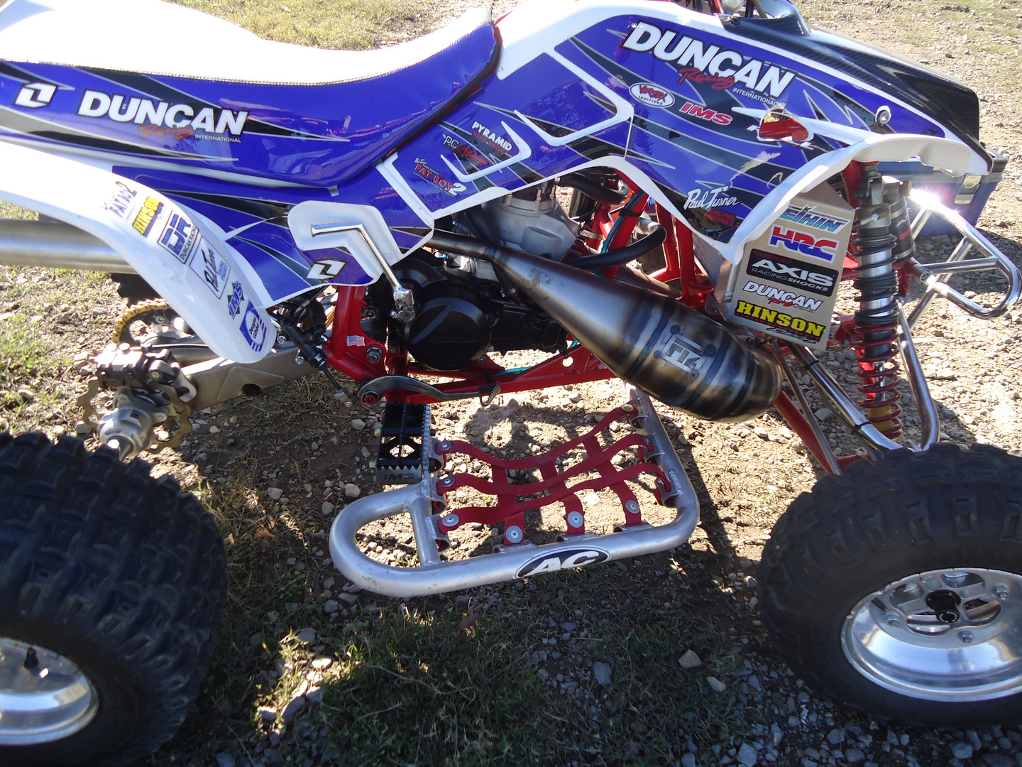

jsc 003-   The engine is a 344 Sphynx.  2001 cr ignition  39mm pwk   Vforce 2 reeds  LED intake setup   Hinson clutch   It was built by FTZ   has a FTZ in frame drag pipe   ported for mid to high end       Runs awesome now that I had a good tuner tune it.  I had the jetting way off. Way to rich.   Has 240 pounds of compression.    Runs on VP 110 with Benol @ 32: 1
