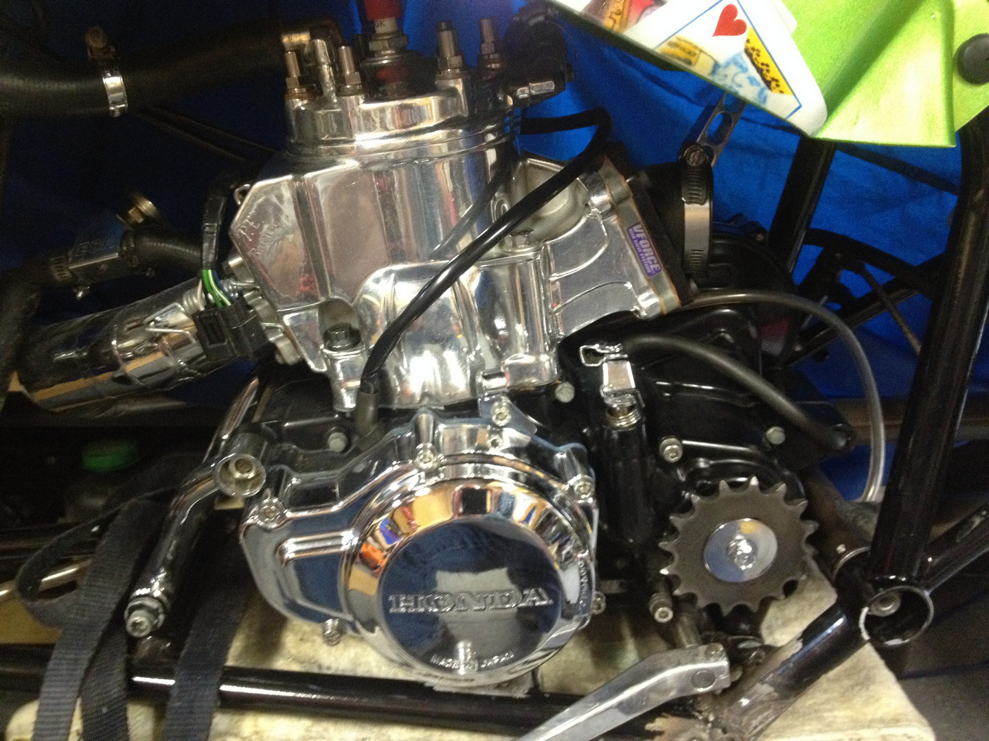

Offline udontknowme
Alky Setup help
« Reply #5 on: December 17, 2014, 07:21:58 PM »
this is what i ended up doing. 45* then a nipple screwed into that. pic doesnt show it but i used thread tape to seal the threads also.  if you go in the side of the intake area i would suggest going in front or above the side of the reed cage. some cages are pretty tight against the intake wall and if its blocking your vacuum hole them ill bet the signal will be very weak. even if theres 1mm or so of space between the cage and intake wall i would still try to locate the vacuum hole above or in front of the cage in a more open area but thats just my opinion. going in the side at the transfer aint a bad spot either. really just a preference thing

ace hardware. cant recall the size. 1/4 pipe thread maybe ?  its a standard pipe thread
Alky Setup help
« Reply #10 on: December 20, 2014, 11:58:19 AM »
Looks like 1/8 pipe from the pictures.
