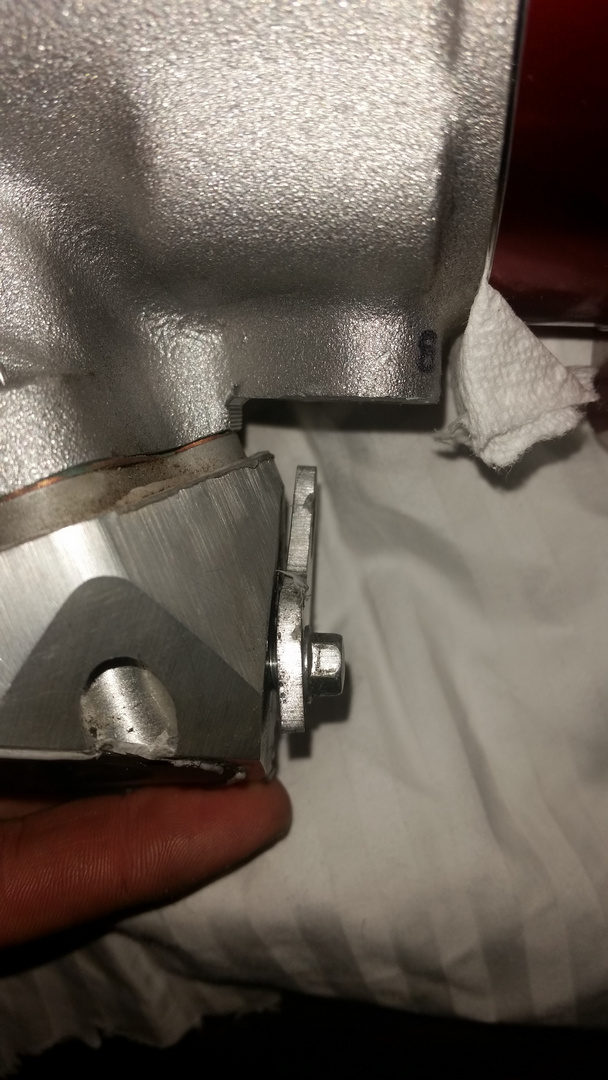

Okay there is a change of plans for the intake. The 363 will be breathing with pulse injection, also known as inertia ram tuning intake.
There are some slight fitment but nothing that can't be made to work. I will be taking my porting tools to grind down the top of the chamber located at the top of reeds.
Here is a picture of the area that need some grinding.
I will also be getting a new fitting for the pulse tube to correct the other issue of the fitting hitting the coolant inlet.

« Reply #10 on: October 21, 2015, 10:20:27 AM »
With that thick of a spacer are you going to have issues with the carb hitting the frame once mounted?
Offline swanitalia
Arens XC 363
« Reply #11 on: October 21, 2015, 10:29:50 AM »
Quote from: Skeans1;60218
There is no spacer, that is the pulse chamber manifold. The carb mounts on the end of the chamber like it would on a normal intake manifold. This has about the same length as a CR250 intake manifold.
