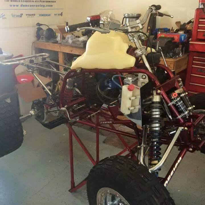

Offline dem3500
Oversized radiator
« Reply #8 on: July 07, 2015, 02:25:01 PM »
i can get some better pics tonight
