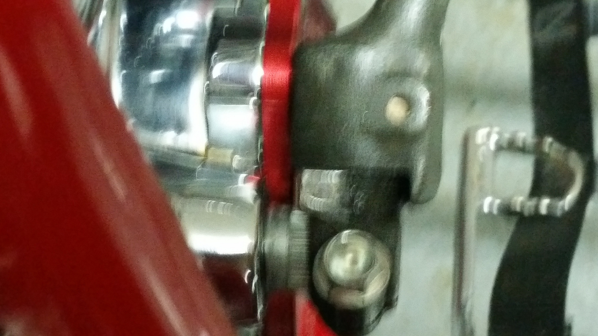

I put on a new hinson clutch cover from ct and the kick starter knuckle hits the cover. Its not  rubbing the cover, it hits and stops the  kicker from even going down.  Either my knuckle is bent or ct welded the  hinson ring on in the wrong place.

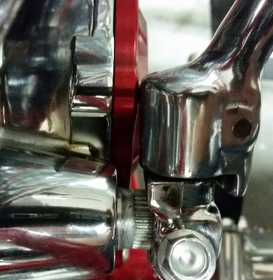

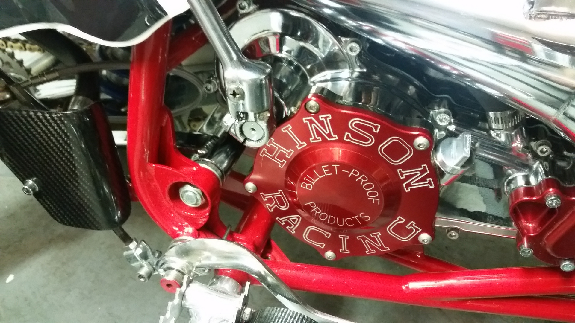

It appears that your kickstart lever is very worn , in the pic the stopper on the knuckle of your kick start is smashed and that might be allowing the lever to move further. I have the same cover and it's close , I could see with just a little play in my lever it would hit the cover, your cover appears to be fine I think it's your lever ......

If you look at the  picture above the kicker is parallel to the cover plate where  mine is definitely at a angle.

if you look closely at the pics, it looks to me like your shifter shaft is not sticking out of the cover as far as contracthunters. the plate is in the exact same spot as his is on his cover so i dont think the problem is in the cover.
