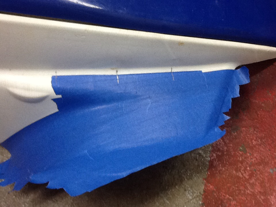

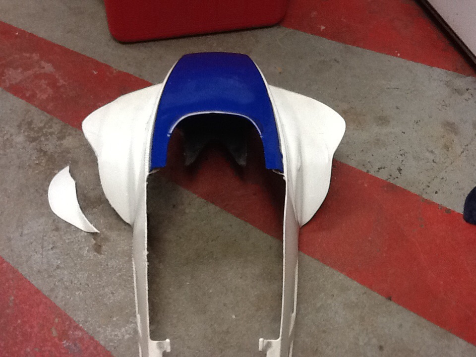

Got these front fenders in a parts lot with a big chunk missing from the right side. They've seen better days but I wanted to try to salvage them & match both sides, so I made a template out of 1" blue tape:

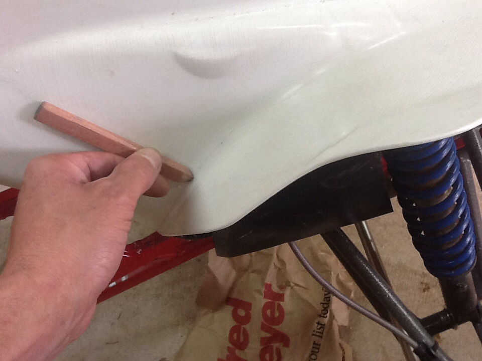

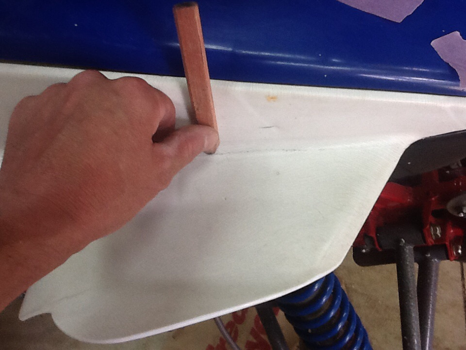

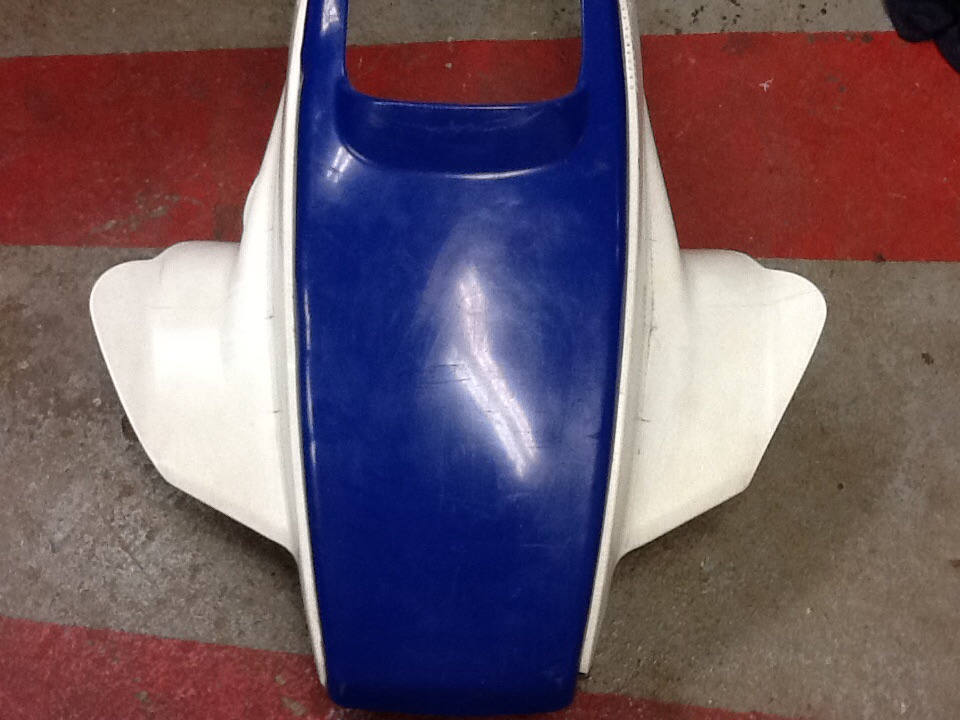

Drew some witness marks. I started by holding the pencil tight to the plastic & following the contour. It doesn't matter where you put the witness marks as long as the measurements are taken from the same place on both sides:

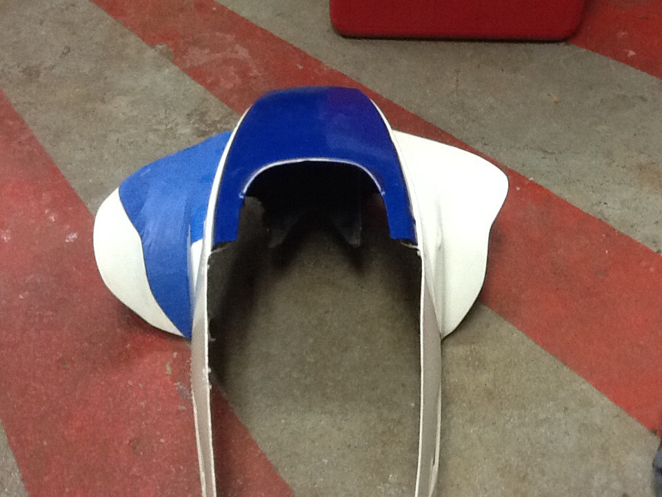

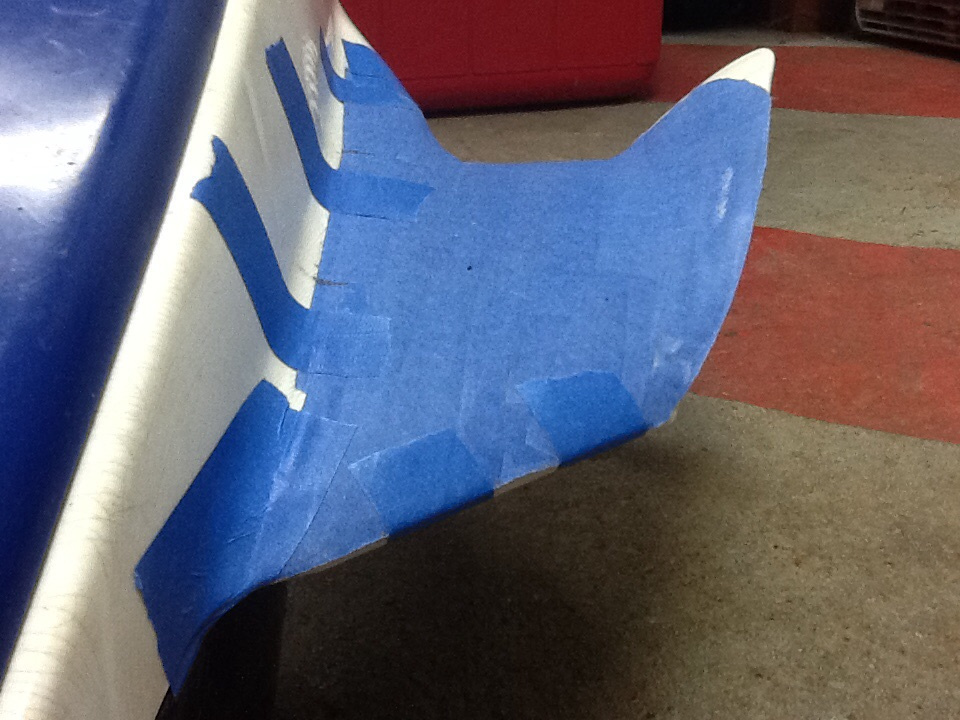

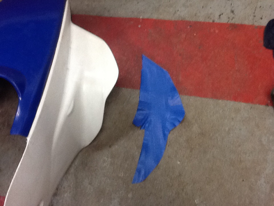

Next I laid down the tape & smoothed it out & transfered the witness marks to the template, than put on a second layer to make it more stable when removing:
Trimmed the edge with an x-acto knife:

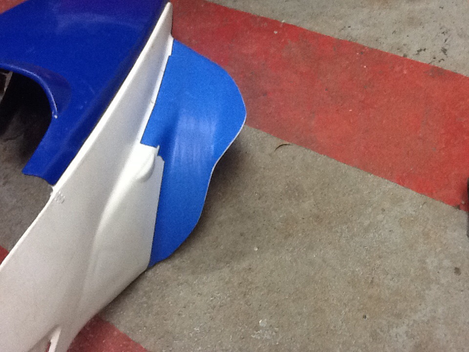

Pulled it off, flipped it over & transfered it to the other side lining it up with the corresponding witness marks:

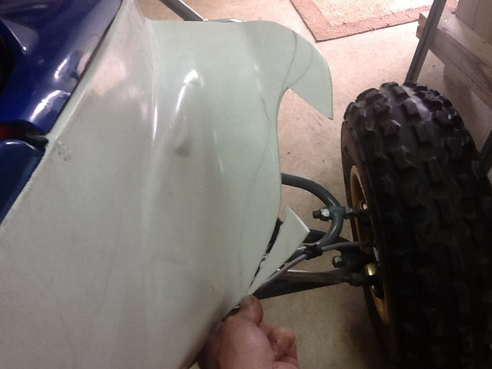

Traced the edge & trimmed the pastic with a die-grinder cut off wheel chucked in a B&D drill & finished the edges with sand paper:
