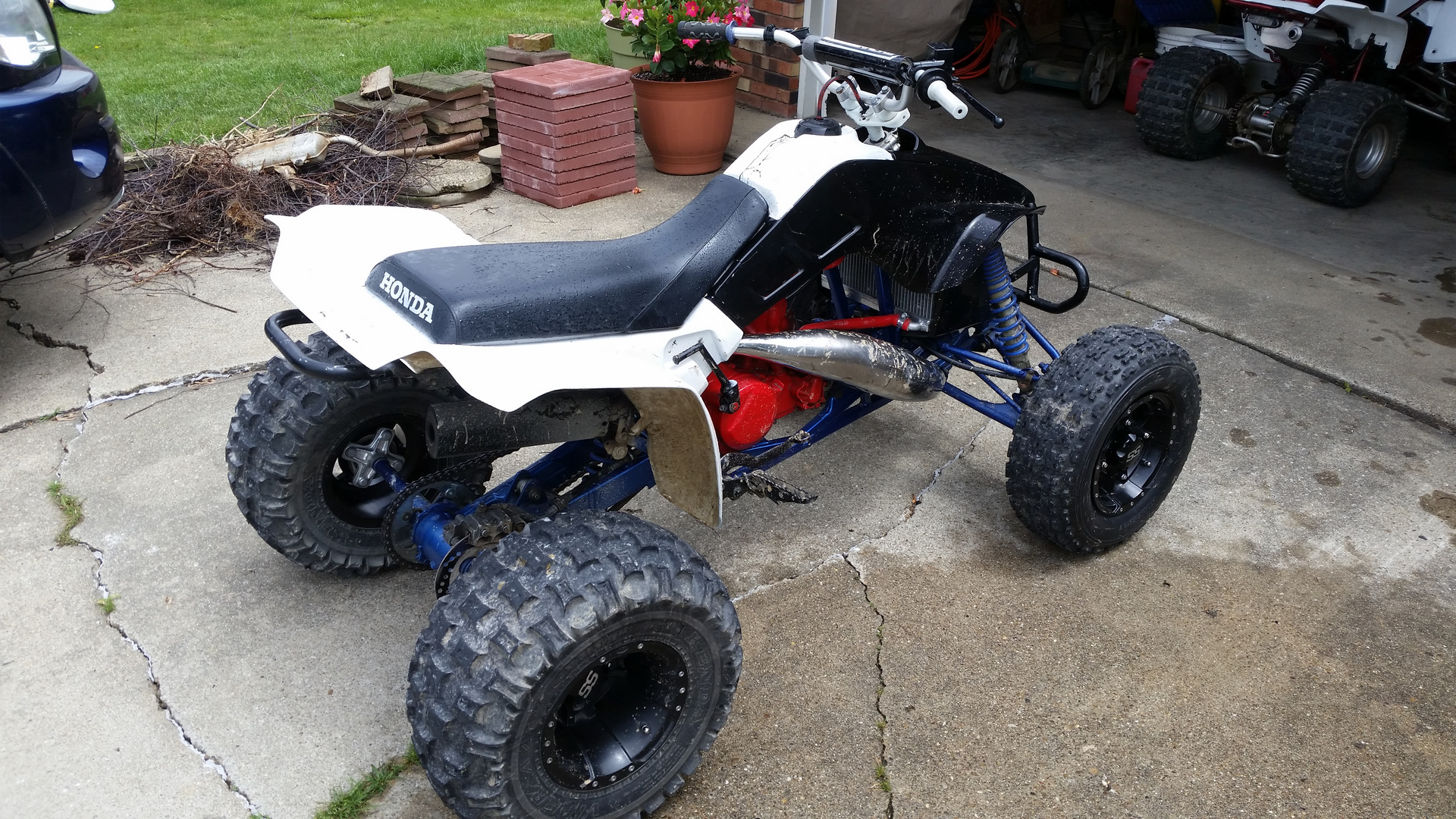

I decided to stick with my stock carb for a little bit longer and I'm gonna need some help with a starting point for jetting. I just bought this 86 trx250r so I am not 100% on the the parts it has. I do know that it has a curtis sparks exhaust but I'm unsure of the which of the sparks exhausts it is. Maybe I can get pictures up for you guys to maybe identify it. I just put a new uni filter on it. I will be running the outerwears cover for a lid and haven't decided if I want to block the stock snorkel or not yet. Guy said it has motor work done but is unsure what. He does know that it was bored .030 over and I can see its the stock cylinder. He also said it must run 93 octane so I'm thinking something has been done to the head for that reason. Other than those things listed, I don't really know the details on what else is done yet. I am at 400' elevation and ride in temps from about 40-90 degrees. It currently is in the low 80s right now. Any ideas on a starting point for jets? Just from what I have read I was thinking starting at 160 on the main and plug chopping to see how close that is and maybe middle clip on the needle and the stock 48 pilot or maybe a 50. What do you guys think though, you would know better than me where to start.
This is all I got for pictures of the pipe. It isn't in the best shape right now. I might send it off the get cleaned up and fix the best they can do if it is the sparks mx because I hear that is an excellent pipe.

If it's a sparks pipe, It should have the letters "mx" or "tt" stamped into the name plate. As far as the jetting, so you are running a stock 34mm PJ carb; is that correct? I would start out with the richest main jet you have, around 175ish or so if you have it. Then work your way down with plug chops. Plus, if the top end is super lazy and flat feeling, then you know you are way rich. As far as the pilot, I would say start with a 45 or so and go up. If it is real "zingy" and doesn't want to idle down, then you know it is too lean. Go up until it settles easily. I doubt anything has been done to the head. It is pretty common for everyone to run 93 pump gas if they are not running race fuel.

I'll have to check again but I don't remember it being stamped with the tt or mx just the sparks plate on the side. Yes I will be running the stock pj 34. I just saw a lot of people running in the high 150s for mains with the sparks exhaust of the jetting sticky. Same thing with high 40s on the pilots as well. I think right now it has a 152 and 48 pilot but when I got it, it had a filthy filter, exhaust was cracked, carb bowl was cracked and had 2 gaskets stacked up on each other and the clip was bent on the needle so no idea where that was supposed to be. I knew when I got it that it wasn't riding right but still had some power. I'm glad I saw this when I did so I didn't run it lean and blow it up. The guy I bought it from rode it and acted like that was normal but I knew something was off. I got a new bowl and rebuild kit in my cart on jets r us as well as a 160 main. I'll probably add a 170 to it and call it a good start for now.

I found out why it didn't have a tt or mx stamped on it; it's because it's a bill's pipe lol. I don't know why I thought it was a sparks
