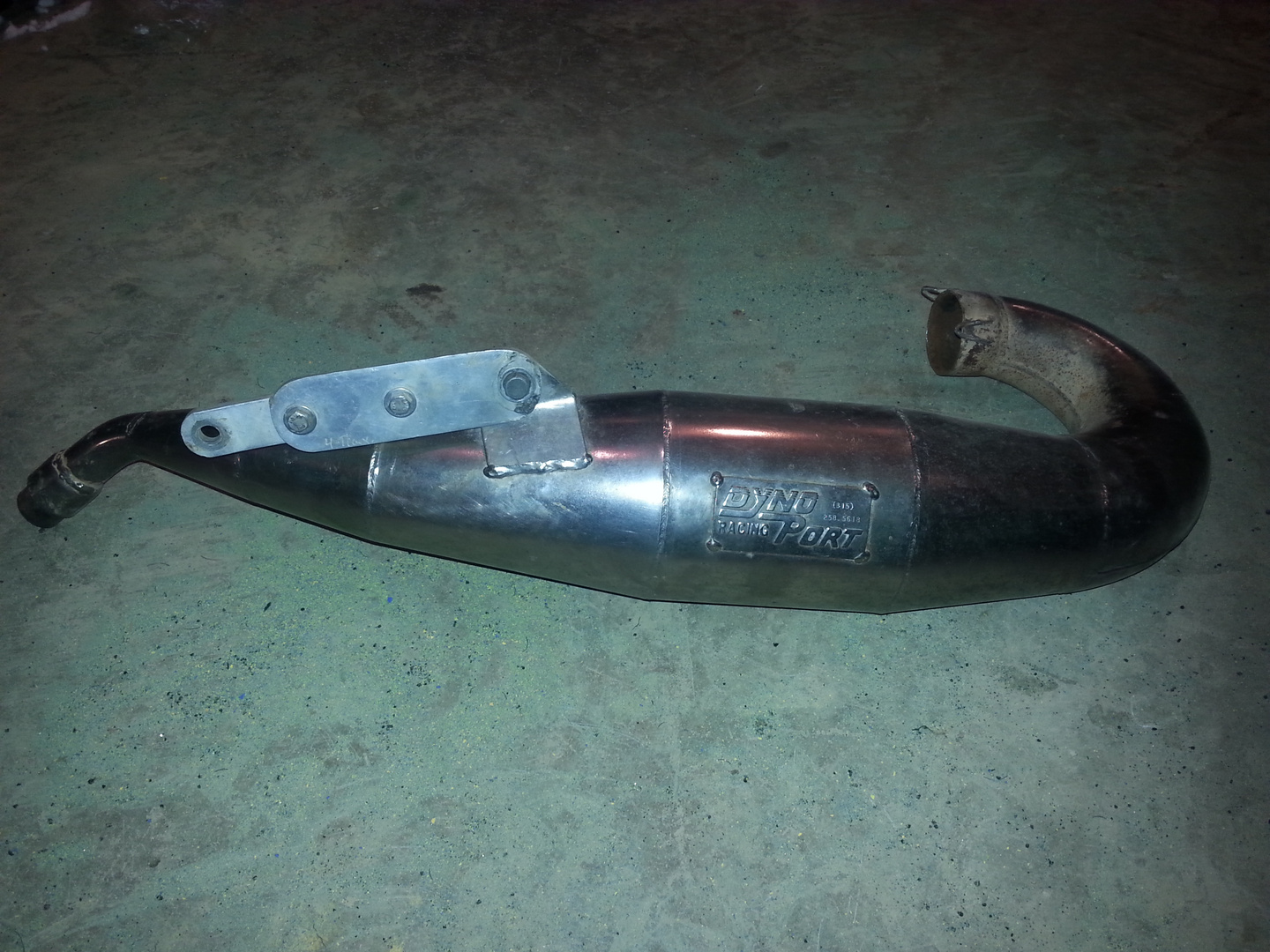

Quote from: aberegg05;23293
Ever heard of a dyno port pipe? I have one and never heard of them
They show up once and a while in the R community.  Some guys swear by them while others have never heard of them.  Personally, I've never seen one nor have I seen dyno comparisons with other similar pipes.  Dynoport seems to be more popular in the sled industry than the ATV industry.
Esr
« Reply #16 on: January 24, 2014, 06:51:08 PM »
If you can ride now pull that fmf and try it out. You are going big though so a b pipe might be better for you from that point alone. Just watch your temps a bit if you run this with your new kit at first to see where your going to be at.
Offline 05450r
Esr
« Reply #17 on: January 24, 2014, 07:00:36 PM »
Dyno port or Krank-It are killer small bore pipes!! But like etccb said above, your up there in the higher cc range and it may not be enough pipe. My Krank-it pipe flat out killed my Sparks Mx on a Hall ported 265, biggest mistake I ever made selling that pipe/silencer. Fyi, Scott at Krank-it hand welded/built pipes from Dyno port stamped pieces that he got from them.
04 450r XC
Offline aberegg05
Esr
« Reply #18 on: January 24, 2014, 07:44:14 PM »
Offline 05450r
Esr
« Reply #19 on: January 24, 2014, 08:01:49 PM »
Yep, good pipe there. Do you have the other piece and the silencer?
04 450r XC
Offline aberegg05
Esr
« Reply #20 on: January 24, 2014, 08:24:15 PM »
Yes I sure do. Whole exhaust
Offline aberegg05
Esr
« Reply #21 on: January 24, 2014, 08:28:25 PM »
How would this pipe do with my set up?
Offline 05450r
Esr
« Reply #22 on: January 24, 2014, 09:05:59 PM »
It might be on the small side, like ecctb said you would have to watch your temps pretty close. On a side note though, pm me if you ever decide to sell it!

« Reply #26 on: November 20, 2014, 01:08:24 PM »
I know this is an older thread, but for what it's worth DynoPort pipes are a WORKS pipe designed to pull throughout the RPM range,  the owner Rich Daly is obsessive about performance; I run his pipes on everything I own and swear by them. You won't have to work so hard to stay on the pipe with his chambers, but they are designed for a specific displacement range.  So if you want performance details for you application, call him directly; they are still in business but do mostly sled stuff now since the quad industry went to 4-stroke.  Krank-It pipes are essentially relabled DynoPort pipes, and are equally good.  Scott Carey at Krank-It used to build some incredibly nasty 2-strokes, mainly 250R motors back in the day. My Blaster has a Krank-It motor in it, and it really puts out.
