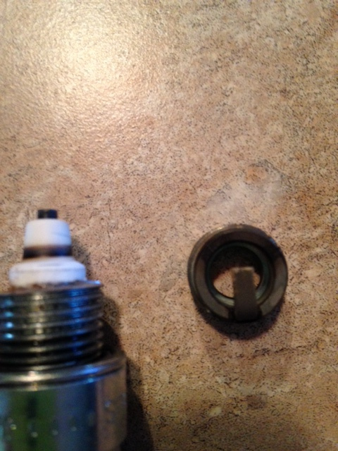

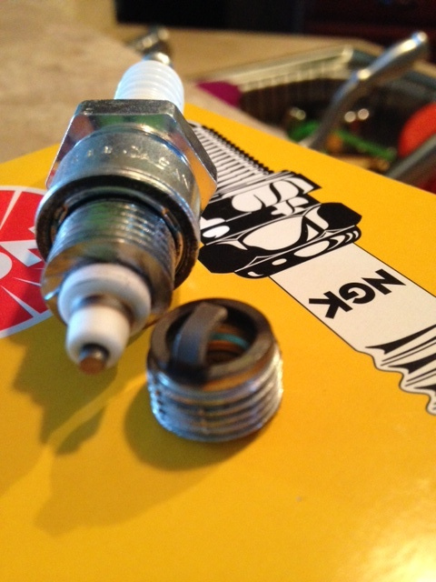

Looks good, cut off the threaded area for a better look at the ring at the ceramic base

Here is with a .022 gap (no difference felt or seen) and the dgh back to the 3rd clip with two WOT runs.  The darker line is blurry (due to camera) at the bottom of the strap.

Looks good! I would leave it where you are at

Dave, thanks for the advice.  I just tried a cej on the 3rd clip but it had a little more sputter up top and it seemed to burn off the ring a little more (leaving it more of a dark gray haze) but slightly darkened the top area of the ceramic some.  I didn't like the strap color though.  Was just a shot to see if I could get just a little more pep out of the low end.
Now when I run it normal at a conservative pace and shifting I get more of a complete black ceramic.  If I put that plug back in and do some WOT throttle runs it seems to clear that up.  Is my low/mid running rich or is that normal?  I ask these questions but I'm pretty sure I'd just rather run rich, especially if it's running fine.  I do think tomorrow I'll throw in a 190 main just to see if it likes it.  I'll also be putting that dgh back in there.

I think reading plugs at part throttle is the hardest thing because until you use some sort of throttle stop its very hard to recreate the same throttle position time and time again, I really try to use the seat of the pants feel for how the bike runs for the lower throttle positions but use the WOT plug readings like you just did in you earlier pictures
IMO just a little rich but not fat pulls better at lower rpms and a little lean on top makes the best power, but to lean will make less power so you have to be carefull.
Maybe try leaving the CEJ in and increase the main jet size to a 190 and adjust your air screw for off idle-1/8 throttle adjustment

So did the DGH with 190 main seam better than DGH with the 188?  You are using kehien main jets correct? never ever use aftermarket main jets they can be way different in flow.
what you have to determine is this a lean breakup or a rich breakup. Seams like a lean breakup so if 190 seams to be a step in the right direction then adding some fuel with the clip position may help without buying a new needle. You want to move the clip lower so it raises the needle and effectively shortens it and richening the 1/4 throttle
Try messing with the air screw and pilot if you want try adding or taking away some fuel around the 1/8 or less throttle position

I just did another run. It wasn't fair since it was about 14* colder than earlier (54* down to 40*). I ran the dgh on the 4th clip to richen it. Once running normal for awhile and finally getting the engine truly warmed up like always I performed a plug chop. This resulted in a little more brown color on the top area of the ceramic and just a tad even dark 2mm ring at the base. One thing it did do was not cover the ring on top of the plug as much. There was actually a bare area.
It did give that pull down low like the cej did. Maybe tomorrow will be like it was today in temp and I can get a good comparison from the clip on the 3rd to the 4th.
