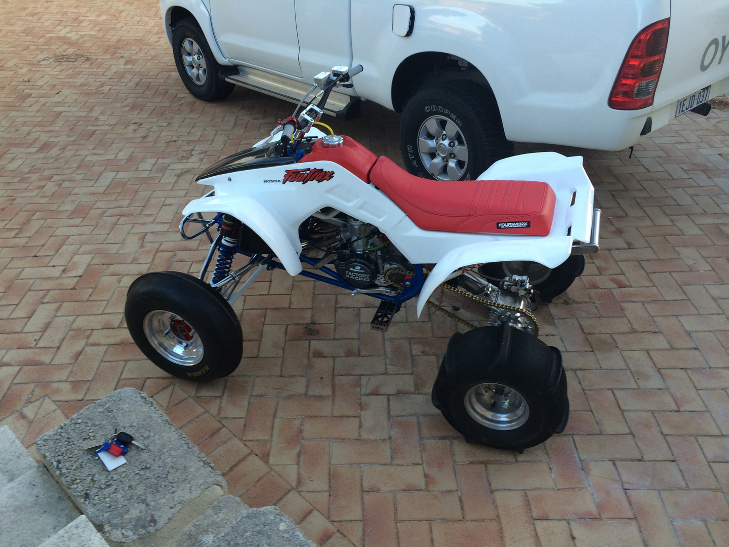

took out to the dunes this weekend and was pretty impressed light as a feather!  found it was pinging quite a bit under load so had to keep short shifting, not sure if its too small main jet or the comp is too high?

Looks really sharp I like the colours. Have you figured out your compression ratio, what's the engine specs?  I would check to see if your using the the right gas and probably go up a few mains as well.

thanks man, its a stock barrel with a CR head gasket and 2 base gaskets as recommended by Allen Knowles and running on 98. From memory i think i put a 165 main in it because im not runing an airbox
