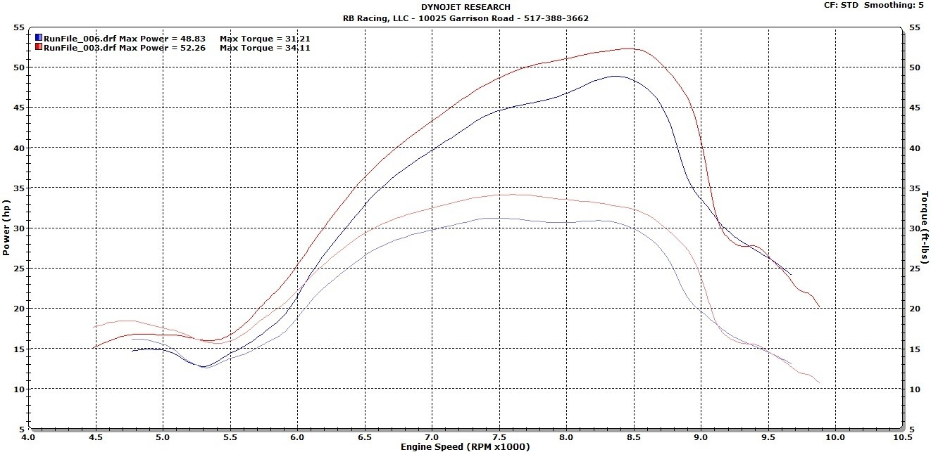

Red is a 310 blue is a stock top end  maybe a 253 ? One size over
Dune port
40.5 Kehin
Cr ign
V force 3 reeds
Trx 5 cm pipe
Race gas
The 310
Dune port
Oem ign
Oem reeds
Trx 5 reg mount pipe
Pump gas

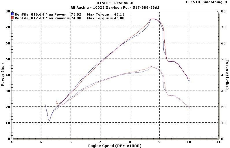

363 pro x alky

What kinda compression and carb was on that stock jug and port job lol

Not sure on the compression
I edited the post to reflect mods

Thats some good numbers Morse! I think I'll get a ESR9 exhaust & maybe a 38mm carb & I will have Arlen tune it properly on his dyno here soon.

I am happy with that stock top end, it hits HARD! However i struggle to find much power on the low end, which is fine with it being strictly a duner R, but would still be nice when riding with the wife, or trying to do a long wheelie(like i said, it hits hard and i've gone over backwards a time or two). The 310 on pump gas surprises me. Tempts me to give mine a shot....
