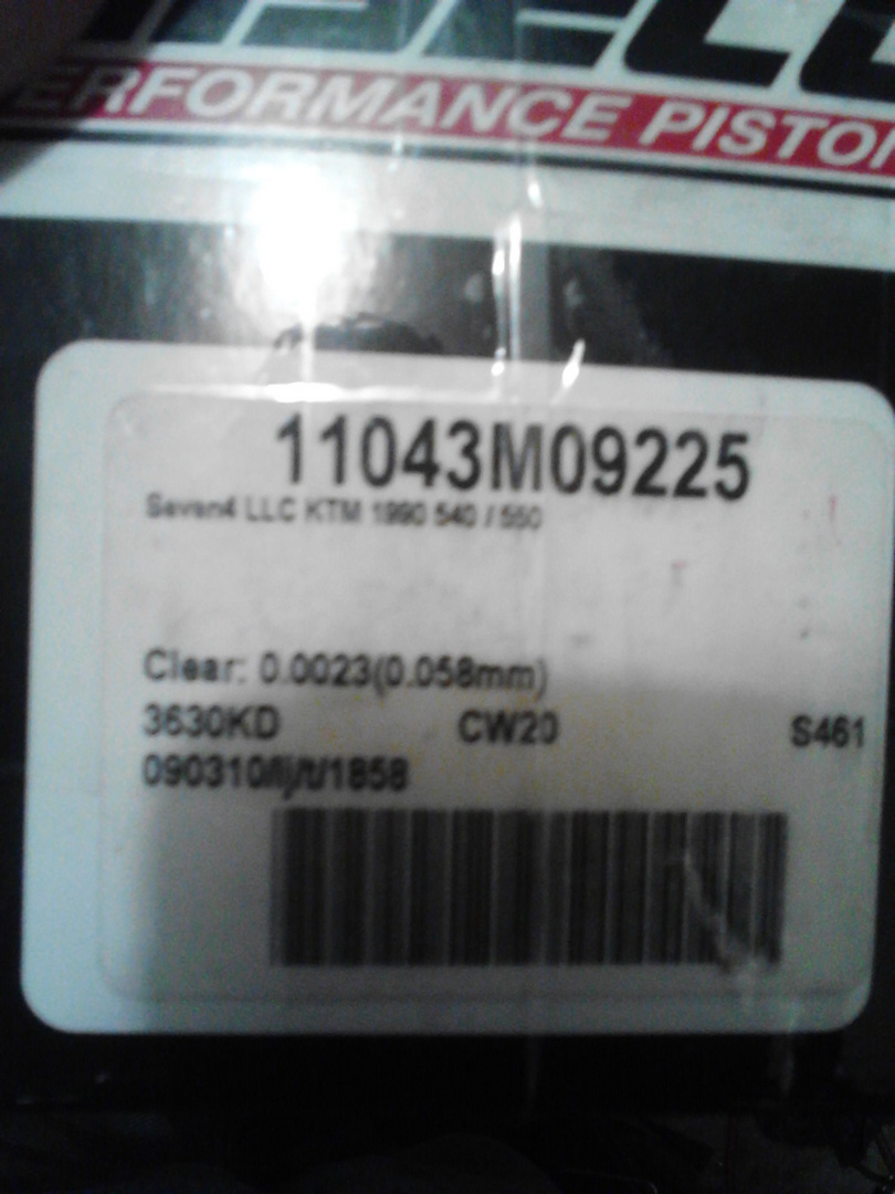

i dont think theres any general rule that say a 125 should have X amount of clearance and a 250 should have Y clearance. theres alot of variables involved. seems like my 300 was a hair over .002 and the 250sx was real similar. one of my ktm 500cc bikes is .0019-.0023 depending if you have mahle or wiseco. so theres really no general rule

i dont think its so much the size of the engine but more so the material and design of the cylinder and piston. no time now but tomorow i could probly show some pics

we have to remember the clearance on the box is only a specification for when the parts are cold. when the engine gets hot everything changes. what the true clearance is when everythings hot i have no idea but i think that is whats most important. you may have .004 on a sphynx or .002 on a 500 but at some operating temp range im sure the true clearance will be about the same between both engines. from these numbers it appears the sphynx and wiseco have quit different expansions as the piston will grow quit a bit more than the cylinder, why else would it need .004 cold clearance. .002 on a 500 seems to have expansion similar between piston and cylinder and there for only a small cold clearance is needed
these are some pretty big pistons yet only need small clearance. if your not familiar with mm then .05mm is just under .002". (.0019" or something like that. ) .065mm is about .0026"
