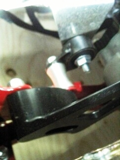

The pipe itself is made to be used with an oem mount. Simular to this.
On the std mount silencer it may go solid with spacer top and oem front..... Dont recall at the moment and the silencer mounting may have changed over the years and maybe it hasn't lol.
Yeah, I'm familiar with this mount on the pipe. I'm just wondering how you mount the silencer with rubber mounts or if it supposed to mount directly to the frame. It looks like it is supposed to mount directly to the frame. But I'm concerned about this creating additional vibrations. Can anyone say for sure?

The above is the one that really saves the vibes and imo there should be a simular setup on all pipes using an oem or oem type mount. On the silencer I would just mount it as it was intended.

That is how I got it sanddad. That photo was taken of a center mount 5. I don't know how the bracket has possibly changed over time or type to type but esr has always used an oem mount down there.
