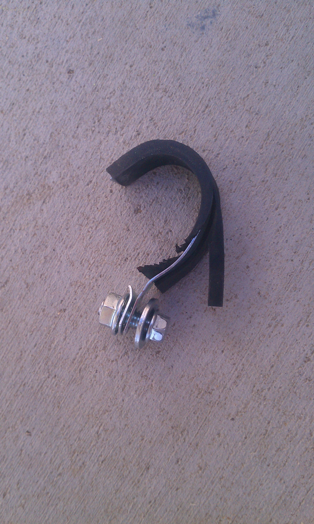

I ripped this idea off from Troybilt. I saw that he used brake line clamps to mount the front of his airbox. I didn't see how they were mounted to the box though. The problem is the frame rails aren't perpendicular to the front of the box so I couldn't bolt them directly to the box. I got some Alba clamps that have a 1"hole and use rubber to size down to 3/4". I got some 3/8" diam rod and welded it to the airbox sticking out parallel with the frame rails. I had to drill out the small hole in the clamps. Now the front of the box is rubber mounted. The rear mount has always been rubber. I hope it holds. The crappy little clamps I had on there broke every time.
I'll let you know if it works
