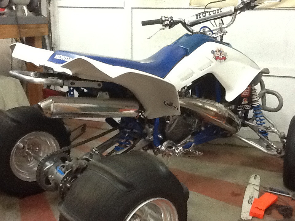

What does this silencer look lime inside? Is it like the turbine core just longer? Need spark arestor here and quiet. I ate thy pretty quiet compared to anything else out there?

They are both a turbine core and longer. I modded one by removing the the sparky stuff and replaced it with more perforated tube. It was definitely quieter than a standard silencer and was still labeled as spark arrested. I don't know what it was like before because I modded it prior to use.

It has a china hat inside (excuse my reference) So the exhaust goes down and hits the cone(hat) then travels around to go out the back. They stick some extra packing around the cone, thats what makes it longer.

My q-silencer with the trx5 pipe was 95db last time I had it checked (2 over the limit here) but quiet enough for johnny law & ranger rick.
My old 89 trx race pipe & fat boy was 118 at idle, it sounded bada$$!

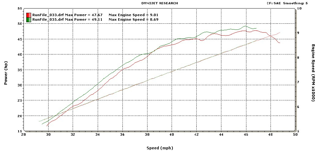

Here are a couple of stabilized dyno test comparing the FMF Q series on a PRO-X 310 cylinder and the ESR Silencer that was made for that pipe.
The red graph has the following set up:
Pro X 310 porting unknown, Spark plug gap .020", 4 th gear run, 38 Air Striker  190 Main jet,  DEJ-3 needle,   1.5 turns air screw,  55 Pilot jet, Stock HB9 CDI Box, ESR TRX 5B With FMF Quite Technology spark arrestor silencer.
The Green graph has the following set up:
Pro X 310 porting unknown, Spark plug gap .020",  4 th gear run, 38 Air Striker  190 Main jet,  DEJ-3 needle,   1.5 turns air screw,  55 Pilot jet,  Stock HB9 CDI Box,   ESR TRX 5 B  With ESR out of frame silencer with the Billet dome shaped end cap on silencer
