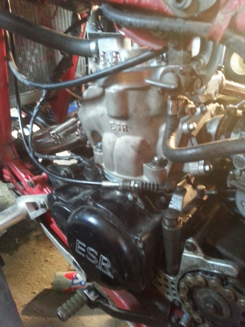

« Reply #4 on: December 02, 2014, 08:41:20 AM »
PWR radiator: upper radiator hose question
« Reply #5 on: December 02, 2014, 09:10:06 AM »
Thanks for the pic Sam. I am curious now though. If you have to turn your head to get the hose to bolt up, how can you run the upper motor mount?
Offline aberegg05
« Reply #6 on: December 02, 2014, 10:03:31 AM »
Best pic I have right now. Ill post another later. U need an 88-89 rad hose. No u do not turn the head.

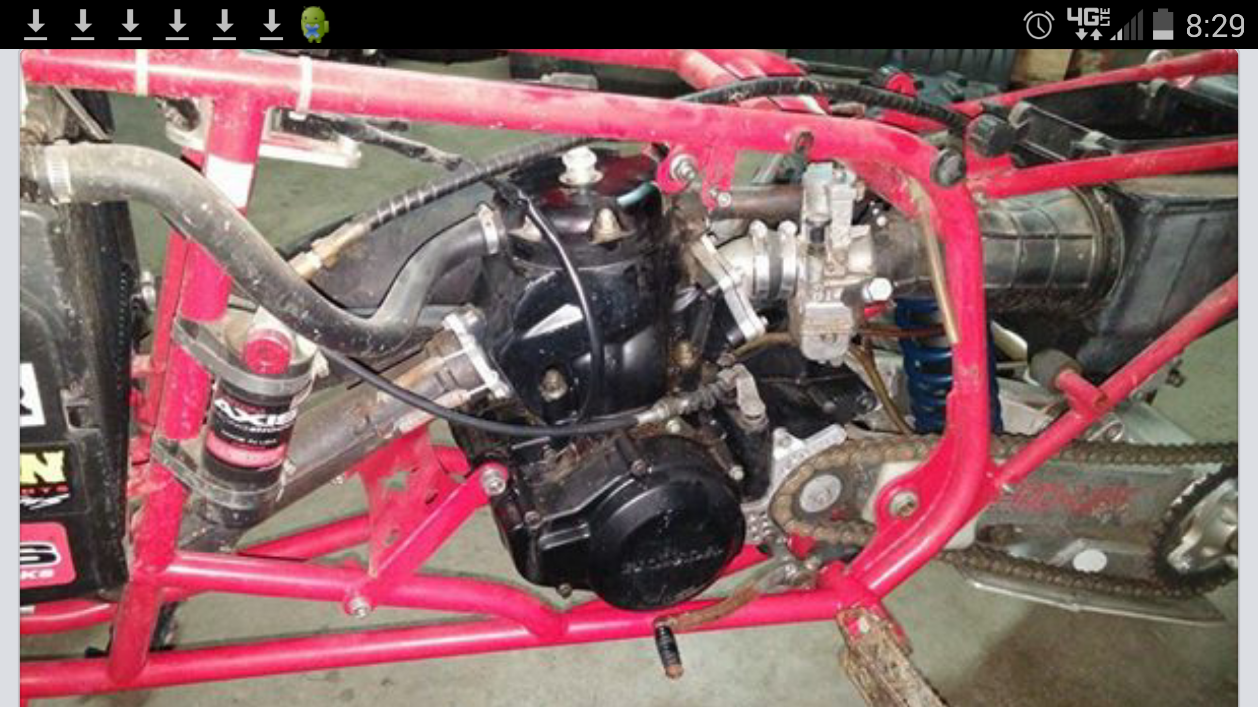

« Reply #9 on: December 02, 2014, 01:32:10 PM »
Not mine but one I found
« Reply #10 on: December 02, 2014, 01:36:34 PM »
Thanks for the pic Josh. That does help. Looks like it's time for some new radiator hoses!
