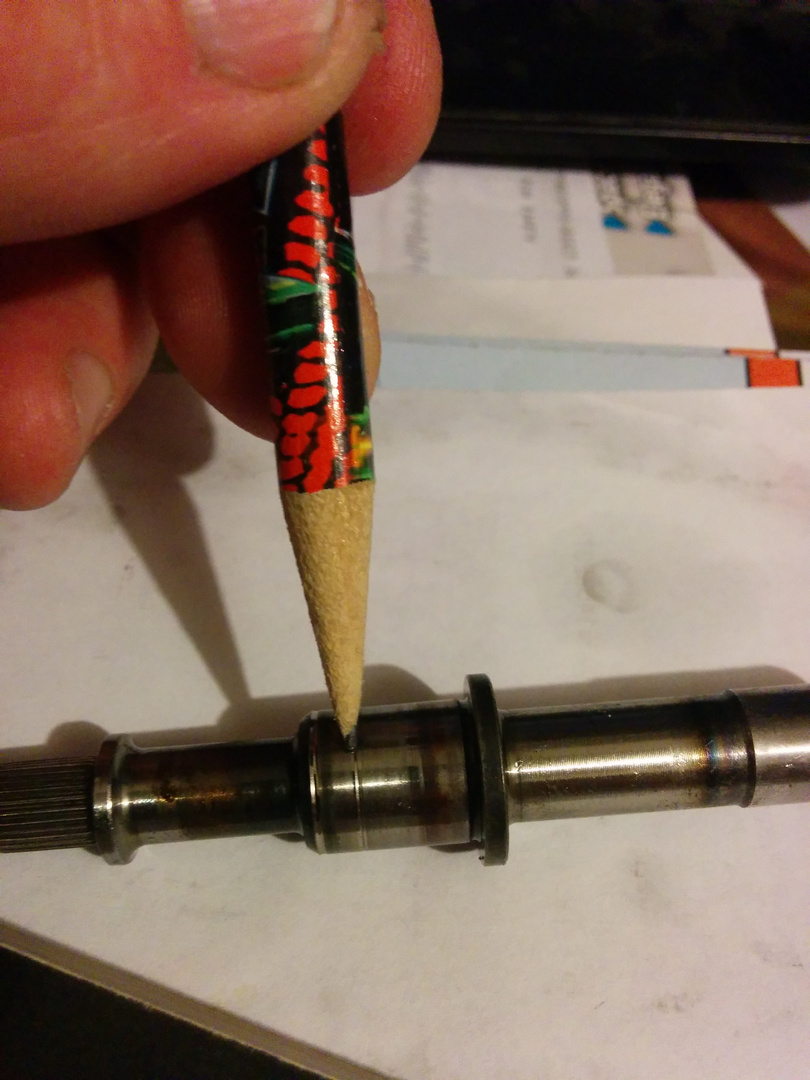

If you look where the pencil is on my impeller shaft you can see a groove on it, it will catch my fingernail. Do you think I should replace that too?

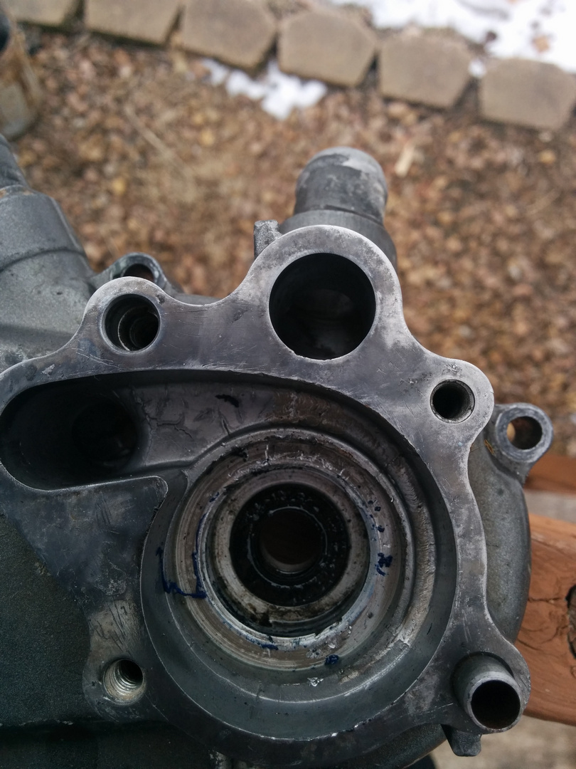

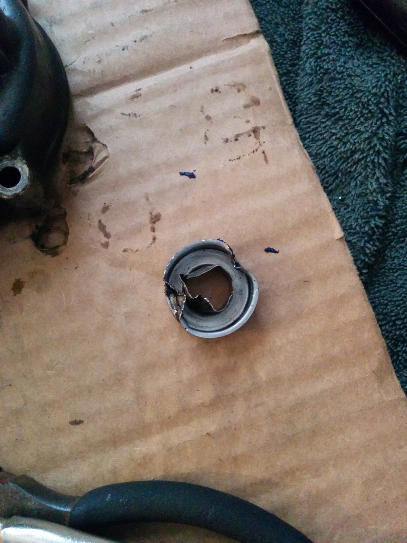

That metal part did not come out easily, that blue sealant they used really locked it in there. I did put some small gouges in the clutch cover though, do you think I should take some fine sand paper and get the aluminum smooth and/or use some type of sealant. I was thinking some kind of permatex silicone type sealant.
The new seal comes with the blue sealer on it. You just want the sand any ridges you may have made taking the old one out. Usually we press them out from the other side in an arbor press without causing damage. Its a little tricky getting the new one in. Some use sockets to press in and others pull it together with a bolt and washers. WP shafts are real spendy. I would just touch that one up with 400 paper and hope it seals OK

The thread locker does not set. It is permanent. Meaning it stays good from when it was made. When you take the old one out from 30 years ago it is the same as when they installed it at the factory. So you do not have to wait at all.

Well we ended up going to my parents today to visit them and my dad has a hyd. press. We got the yamaha seal pressed in and the water pump put back together. We used some non hardening permatex form a gasket on the mech. seal just in case. I dont have it back on the R yet but I did fill it with water and blew in the hose end and it didnt leak so hopefully tomorrow I should have it running again.
